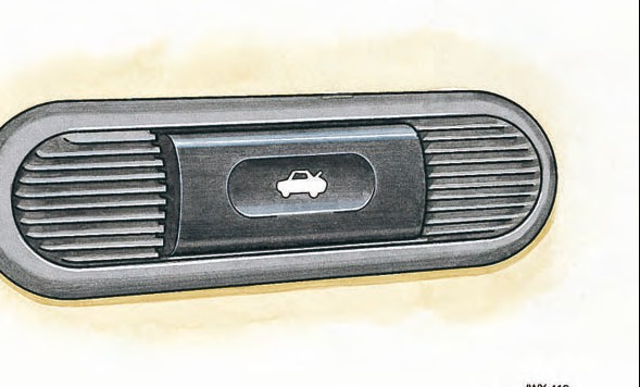

This involves a 1998 XJ-8. Upon startup, the A/C cools the cabin down, but after the cabin reaches the desired temperature the A/C starts blowing hot air. Even changing the temperature setting to Low at this point does not make a difference. The refrigerant level is OK. The ambient temperature sensor appear to be working properly as the system does display the correct outside temperature. Is there an in car temperature sensor that could be faulty, and where is it located?

On my XJR I believe it's located right next to the trunk release behind the grill. See Image... Somebody please correct me if I'm wrong.
