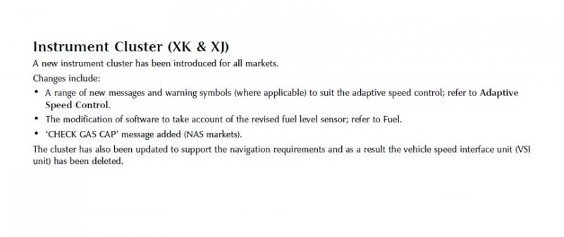

That is a fair enough explanation, but if it was developed for after 2003, then why was the light fitted to 98-03 cars? It was on the XK8/R before then anyway I'm fairly sure because I remember seeing an advert for it or a brochure feature on it.
Old Dec 7, 2011 | 02:35 PM
xjrguy's Avatar
Joined: Sep 2010
Posts: 2,114
Likes: 976
From: Indianapolis, IN
Ya know! You caught me there! Old age creepin' up. The more I think about it, there were some very rare XK8/XKR models with the adaptive cruise. What made me recall that is I once had a prototype X202 in the shop that was a Delphi development mule for the later 2nd generation adaptive cruise. We had to hunt down a 2001 XKR with ACC to swap some parts with. So that does explain the telltail in the instruments at that early date. But the XJ explanation still holds, it went away in 2003, the XK still had 3 more years beyond that, on top of the new engine and engine management.
1000 pardons!

By some bizarre quirk of fate, I just ran across this tidbit this morning while researching another matter, it is from the 2001 MY Technical Update:
Cheers,
