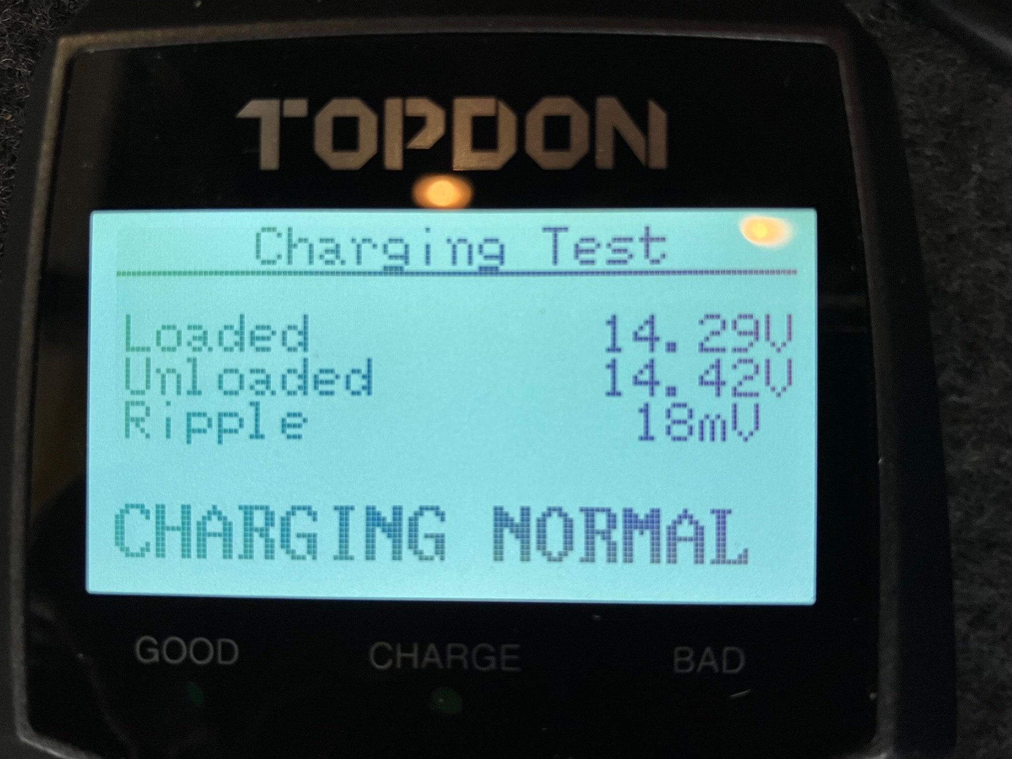

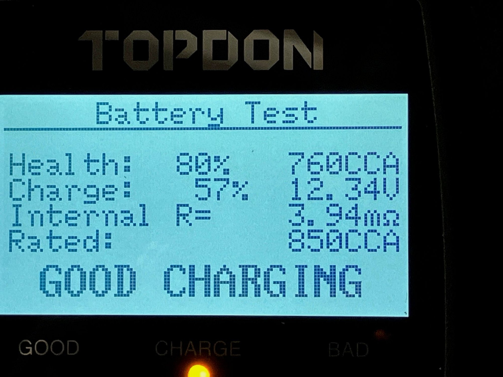

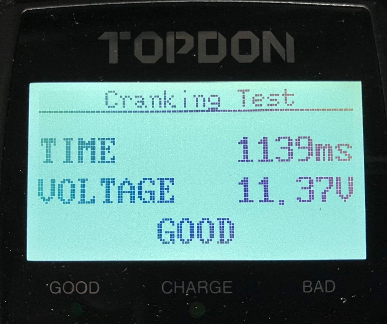

I ran a few tests today as a check on the battery health (Battery health, cranking test, and charging test). Screenshots of the tests are below.

Battery health of 80% and state of charge of 57% will hopefully improve when the battery is fully charged, but are currently no good for a Jaguar.
The 10.98 volts while cranking is borderline for a Jaguar. If the voltage sags to about 10.5 volts while cranking, the ECM will not trigger the ignition to fire.

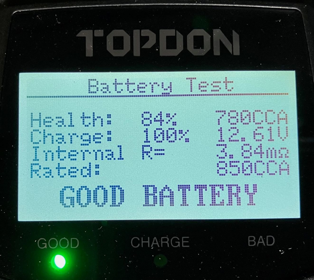

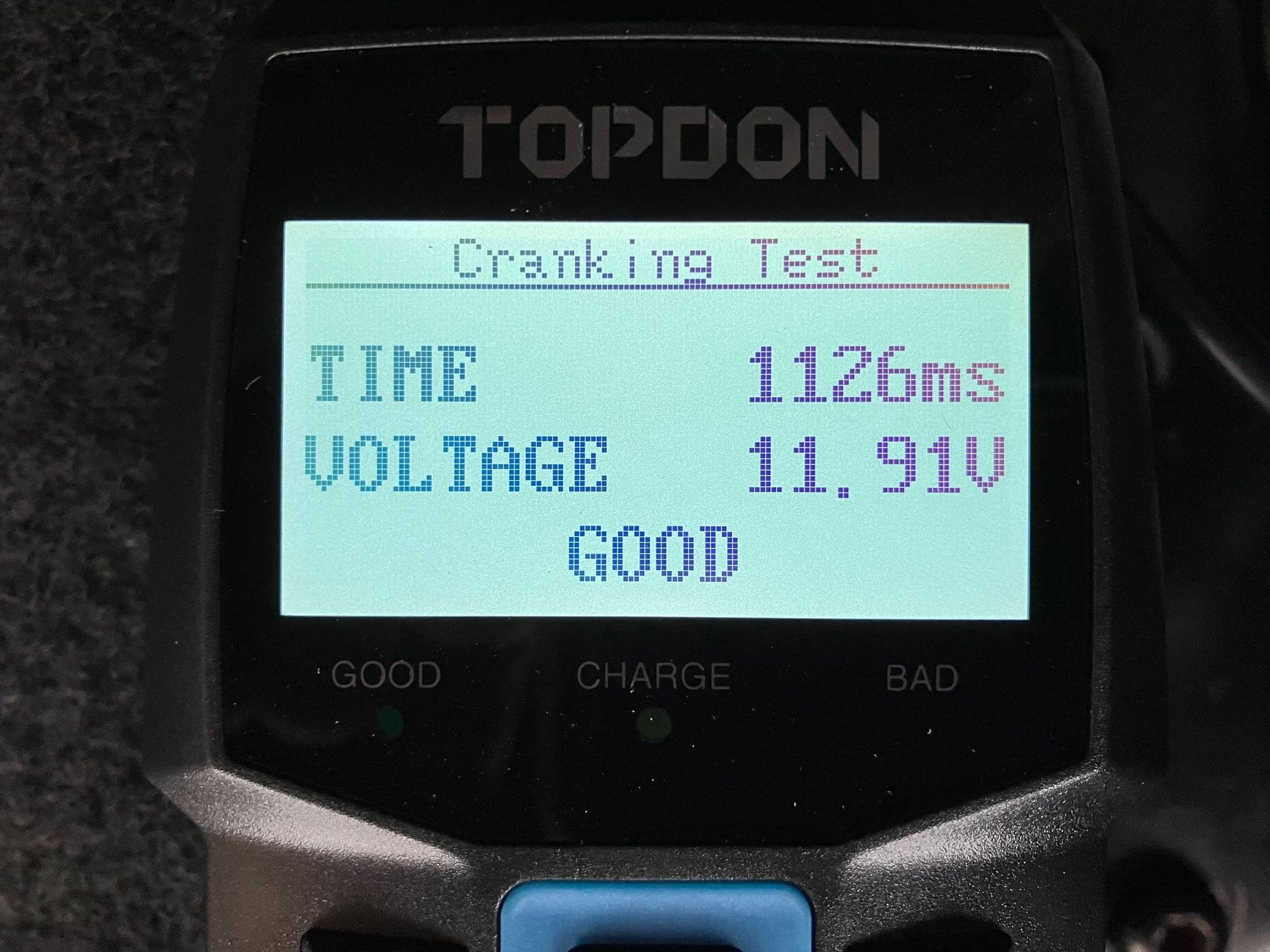

Test results improved when the battery was fully charged. I'll be traveling next week for 8 days, so we'll see where it sits when I return.

With the battery Cold Cranking Amps capacity at 84% after being charged, it's tired. Probably time to replace it.

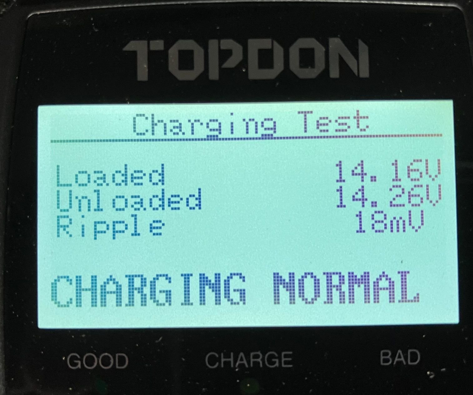

New Diehard 900 CCA AGM battery is now installed. We'll see how this holds up over a week of my absence without a trickle charger.
