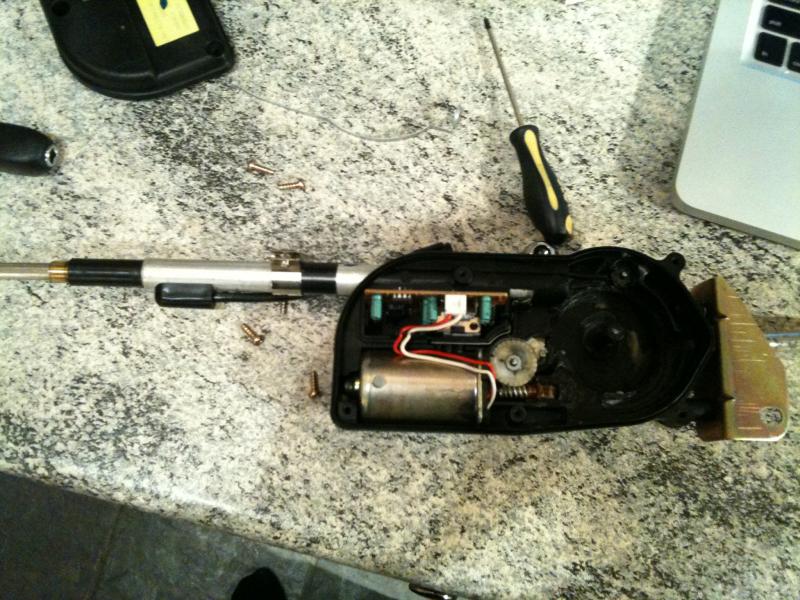

OK I've got it all apart, but can't get the old metal mast out of the tube. Any thoughts?
