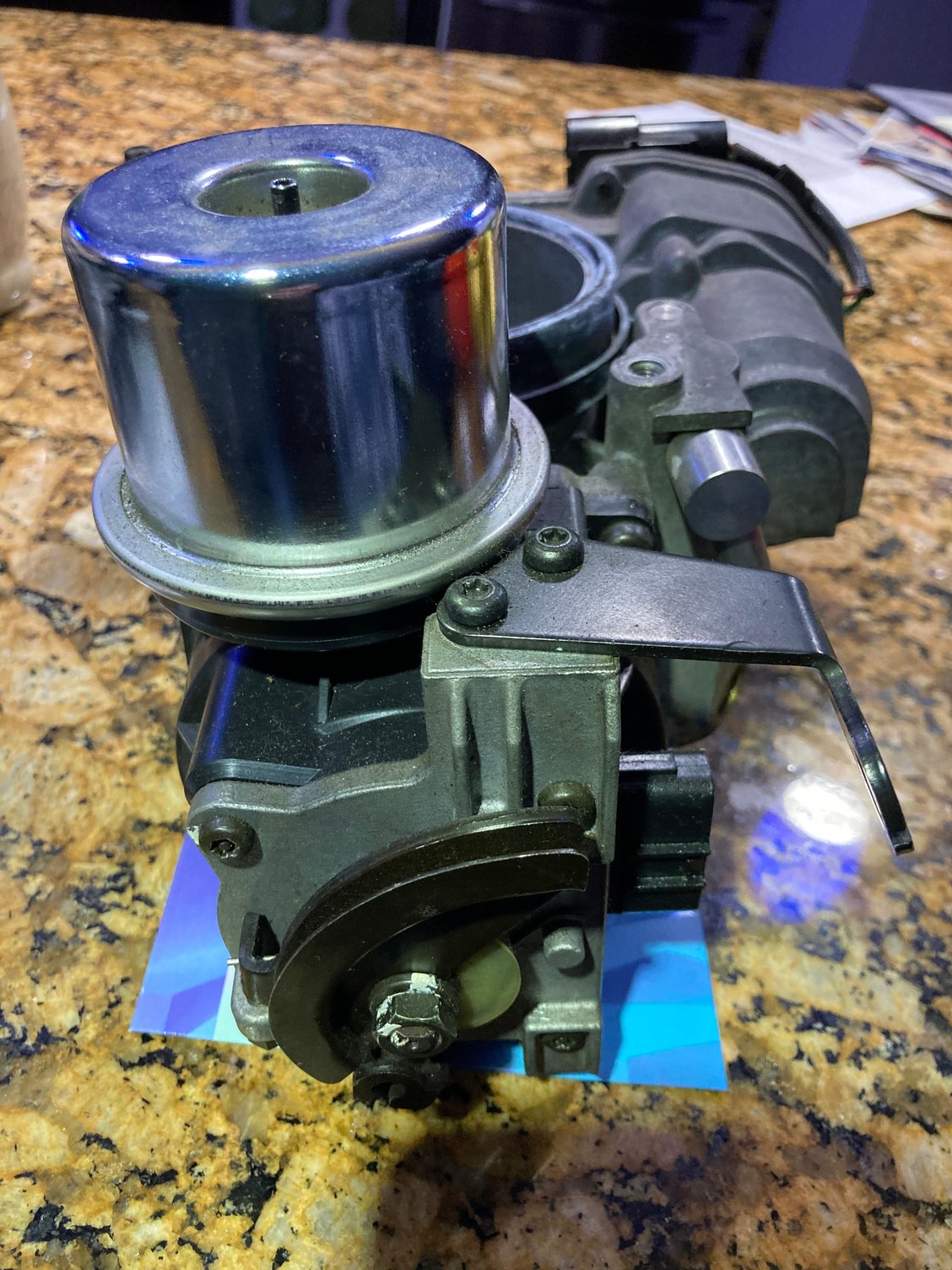

Wished I had saved a throttle body from that era and had a 'chrome' actuator to 'show-off' as original on some AJ26 equipped car.
Kinda like this one Bob?
