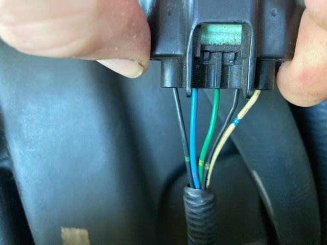

Look at the two black wires very close as the two colored bands are very similar. One seems yellow while the other looks lime colored. You may have to take the black corrugated wire cover off the harness and look further down the wires to get an accurate color of those two bands.
Here is the correct wiring:

and thats the wiring you used for the new maf?
For me then it is the change in the middle 3.
Old Jul 11, 2024 | 07:52 AM
Quadcammer's Avatar
Joined: May 2022
Posts: 528
Likes: 231
From: Clifton, NJ
yes, thats the wiring for the 27 maf
