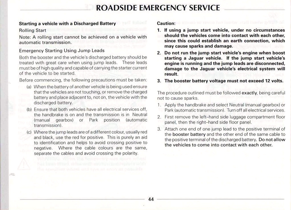

Jaguar advice for emergency starting is as follows:
(click on the images to enlarge them)
NOTE the warning about not running the boost vehicle's engine when boost starting a Jaguar. Several members have fried sensitive electronics by ignoring this advice.

I have no clue where the story about flooding the car came from! The Jaguar recommended procedure is obviously what you should follow if you have any concerns, but I have jumped my various Jaguars from a car with a running engine and never had a problem. I would guess their concern is with a battery with an complete open circuit failure, since it will not "float" the voltage in the discharged car.
Since you did not specifically say, i asume you can get in the trunk with the key. If not, just use the underhood terminal on the fuse panel as the positive lead, and a bolt on the shock tower for negative, then open the trunk and jump as described in the document.
I propmise you there is little difference between a MY 99 Jaguar's electronics and any other modern car.
