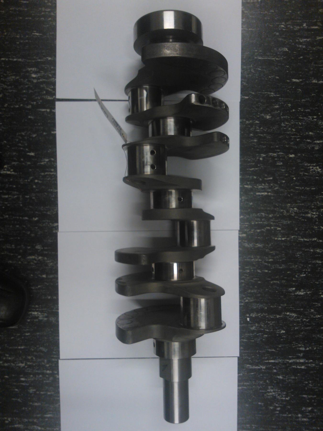

Here my all forged internals.

First of all, thanks a lot for the pictures Sami, i really appreciate this!
Andre, the reason i think the stock parts would't handle let's say 800+hp is that every company looking for the cheapest working part for their solution. And that's more then 200% of the stock power output.
Pending on the infos XJR-99 provided it's maybe worth for trying the Arden kit in it's deliverd form.
