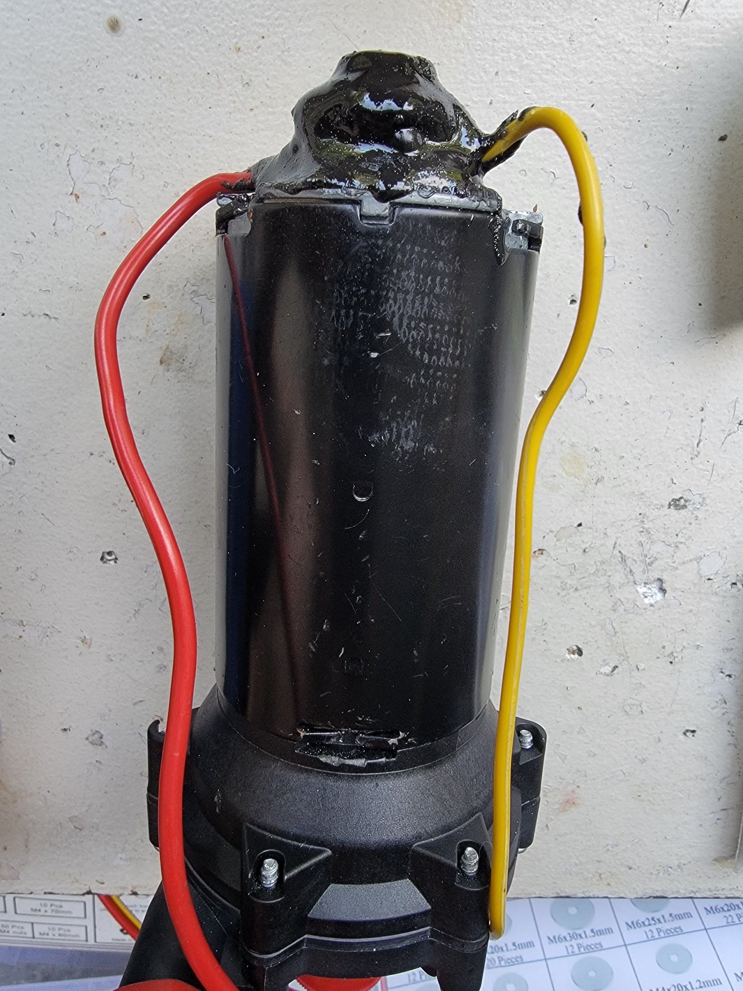

I found the MB pins on the 010 Bosch pumps flimsy. After soldering, they both broke off. There is no use opening up the pump, either by unscrewing the bottom or unlocking the tabs. The electrical connector doesn't have enough clearance to pull off the cover. You can hacksaw off the plastic connector to reveal fairly meaty connectors. Careful not to pull hard because the inside wires are thin. Melt away the plastic over the connectors and solder. Then push back in and coat everything with epoxy.

I didn't get the connector. Just soldered to connectors underneath pins.

Default Soldered under the pins
cripe
