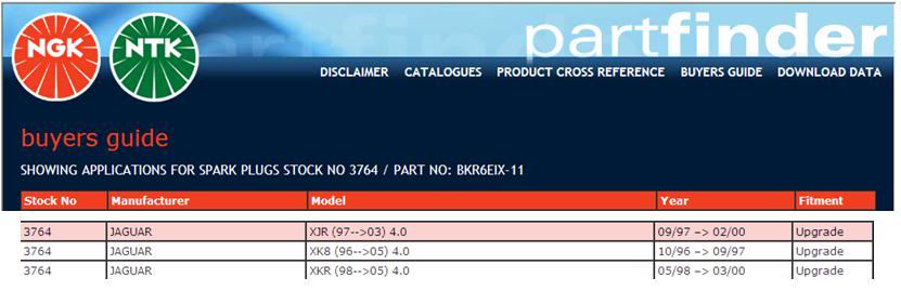

Hi
Here are extracts from the sparkplug chart on the NGK UK website.
Note - the information for XJR model 97-03 4.0 Year 03/00 -> 03/02
is on 1st chart as -Stock# 5464 Part# BKR5EIX-11
also XJR model 97-03 4.0 Year 09/97 -> 02/00
is on the 2nd chart as - Stock# 3764 Part# BKR6EIX
Looks like both of these spark plugs can be used on certain XJR model years.

Here is the weblink to NGK UK sparkplug buying guide:
NGK Partfinder Buyers Guide
