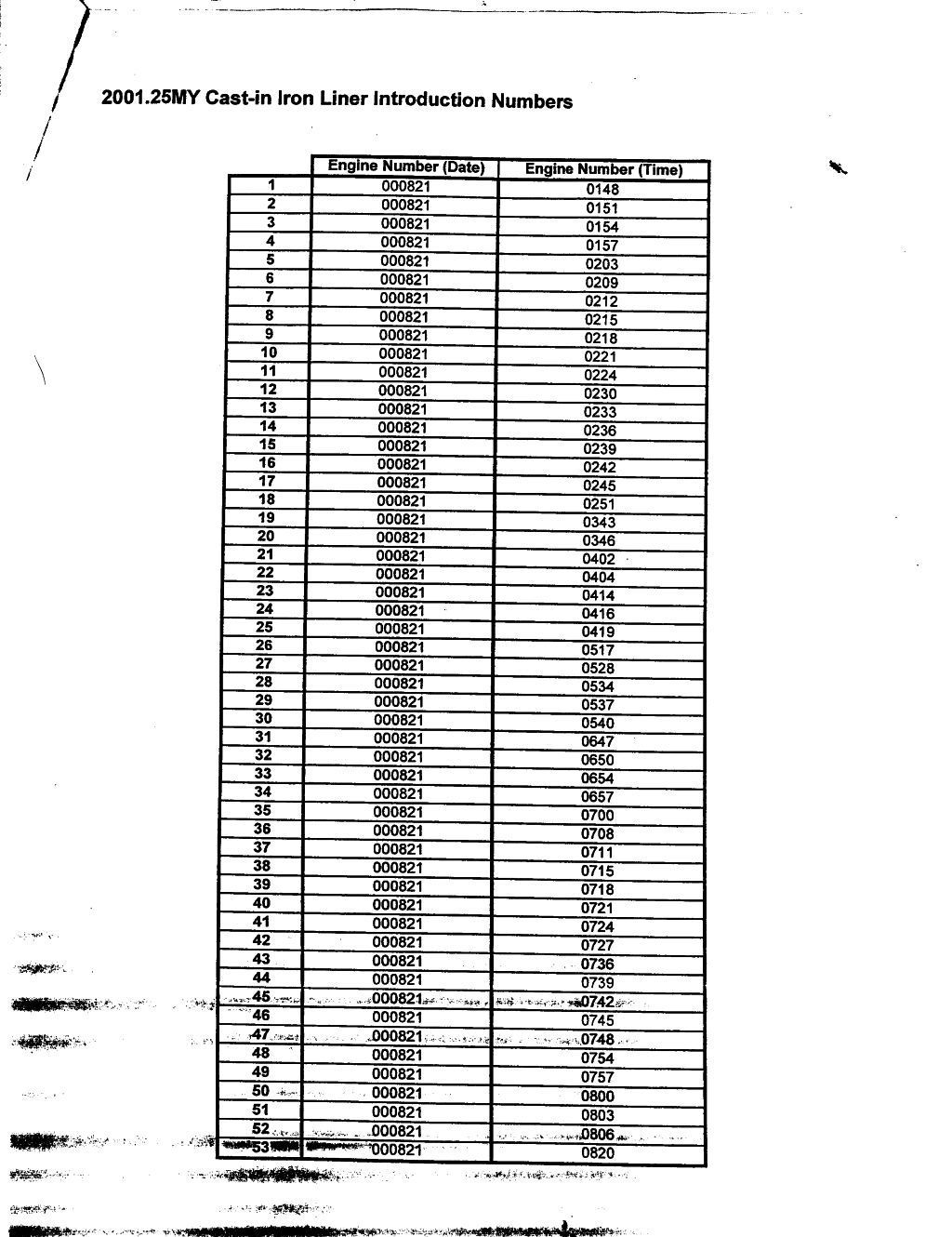

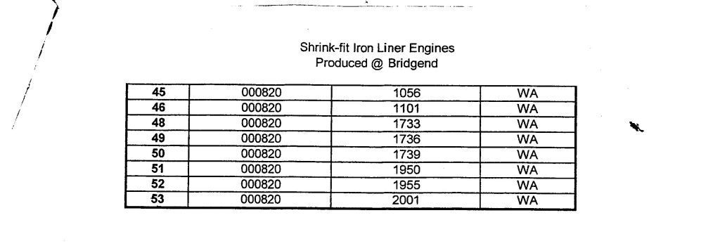

Jaguar used Nikasil blocks until August 18 2000 when they were experimenting with CAST IN and SHRINK FIT liners.
I made .jpg copies of a memo I got at Jaguar training when they were trying to explain the problems with the AJV8 blocks.
