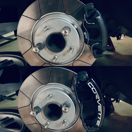

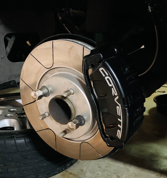

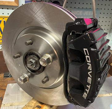

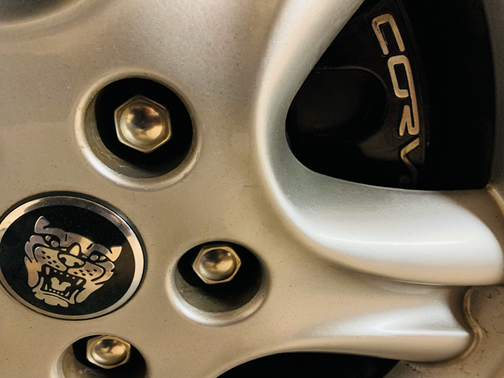

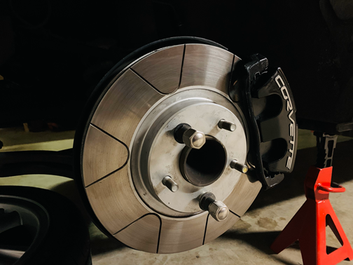

About a year ago I set C6 calipers up on 325mm Jag rotors with stainless lines front and rear (Vette based). Inexpensive and works well, fit 18" Pentas easily. May fit 17", will not fit 16". Last pic is a C5/325mm setup I finished and will be putting on my X300 with the same Pentas.
Before and after:
C5 on 325 for X300 with 18":
C6 in a Penta:
My 308 now has BBS 20's and will be going to 14" and four pot Brembos. I'm sure many will dislike the "Corvette" script, easily removed with a flapper disc for aluminum, you don't see it much behind the wheel anyway.
Not a kit, not for sale. Easy to CAD something up and make, that's what I did. 1/2 steel was used.
