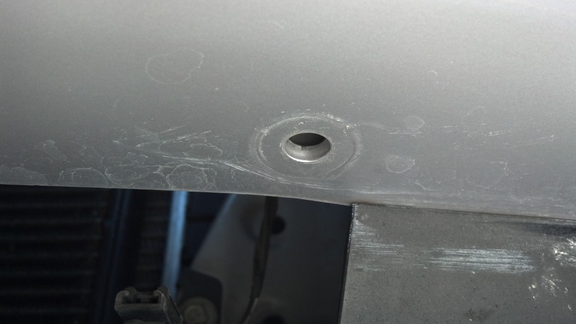

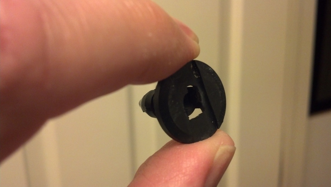

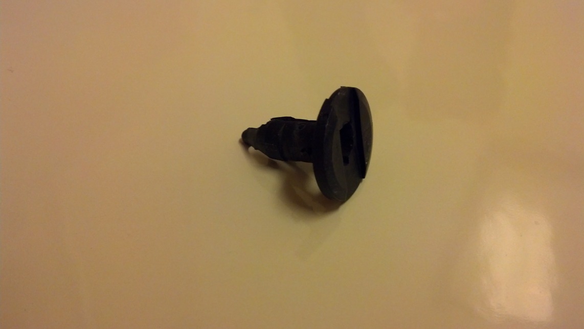

Washing my Jag & clip fell off the front bumper skin. This is not the torx screw lower down. I saw the hole & the other 3 clips in place but just pushing it back in or rotating it will not secure it. The clip is either broken or missing a “cap.”
What is this called? (bumper clip?)
I don’t see it on the parts diagram:
2000 JAGUAR XJ8 Parts - Direct JPLV Porsche Parts.com
Please see 4 photos; 2 views of clip that fell out, hole where it goes & an intact clip securely in place.
If I need a new clip, I need to know what it is called & how to install it. Will a new one just push into place? Or do I push in & rotate 90 degrees? Or is mine OK & just missing a decorative cap that no one will see & I am incorrectly installing it?

If they are 4 and are under the bumper, it's a rokut rivet and the part # is KRB100003
You just push them in. the center part goes in and expend the outside legs/body.
To remove them you first have to pull out the center part

luc, you are correct! So, is yeldogt. I entered the part # KRB100003 in the Gaudin Jaguar search & it returned that part #14 on the diagram I had linked. “Impact bar rivet.” Since list price is only $1.30, I doubt my local dealer will gouge me. They typically charge list price.
Luc’s explanation makes perfect sense, that missing cap is needed to spread the body apart so it holds securely, w/o the cap it falls out easily, as did mine. I looked under the rear bumper & on both sides & see no more of these rivets. Just the 4 under the front bumper.
I’ll call & try to obtain the new rivet Monday.
