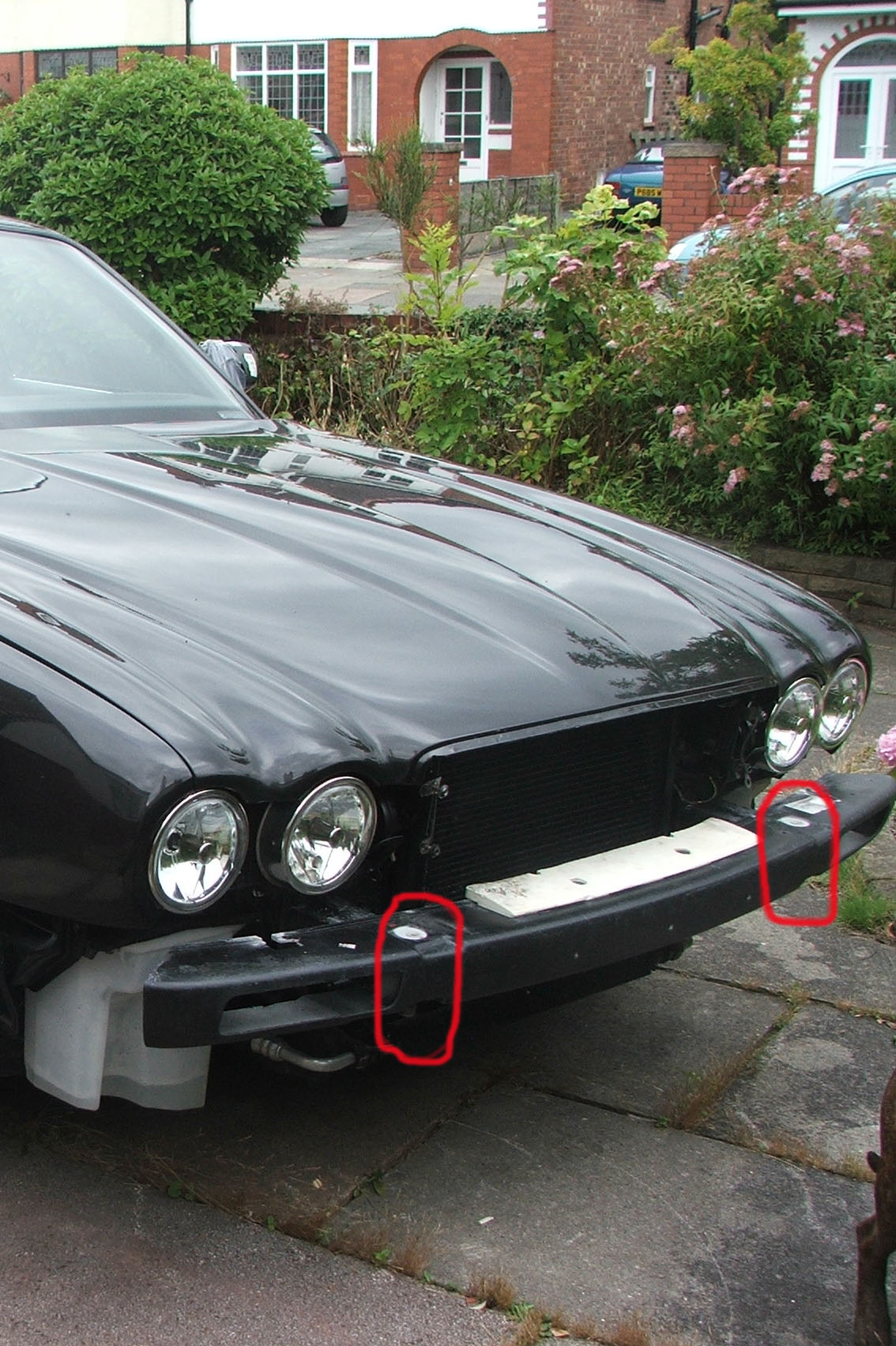

All were fitted correctly. The guides left and right are fine. Bumper doesn't stick out. But they just all hang badly. Even with the bumper adjusters fully extended it just hangs. Below the headlight bezels is about 9 mm space on each side...

Yeh, you need to remove the front bumper, then strip off the outer skin. Your left with a composite bar with 2 bolt guides. If the bumper has had an impact or bimetallic reaction, then these tubes could be knackered. Use something like an epoxy or fiber glass filler to reset the tubes. Get a picture or the issue?
Are the carriers in some XJs out of steel? Mine is all plastic... Plastic plastic plastic... Super fanplastic
As I need to respray the bugger, I'll strip it right down to the bare frame and have a look there again.
