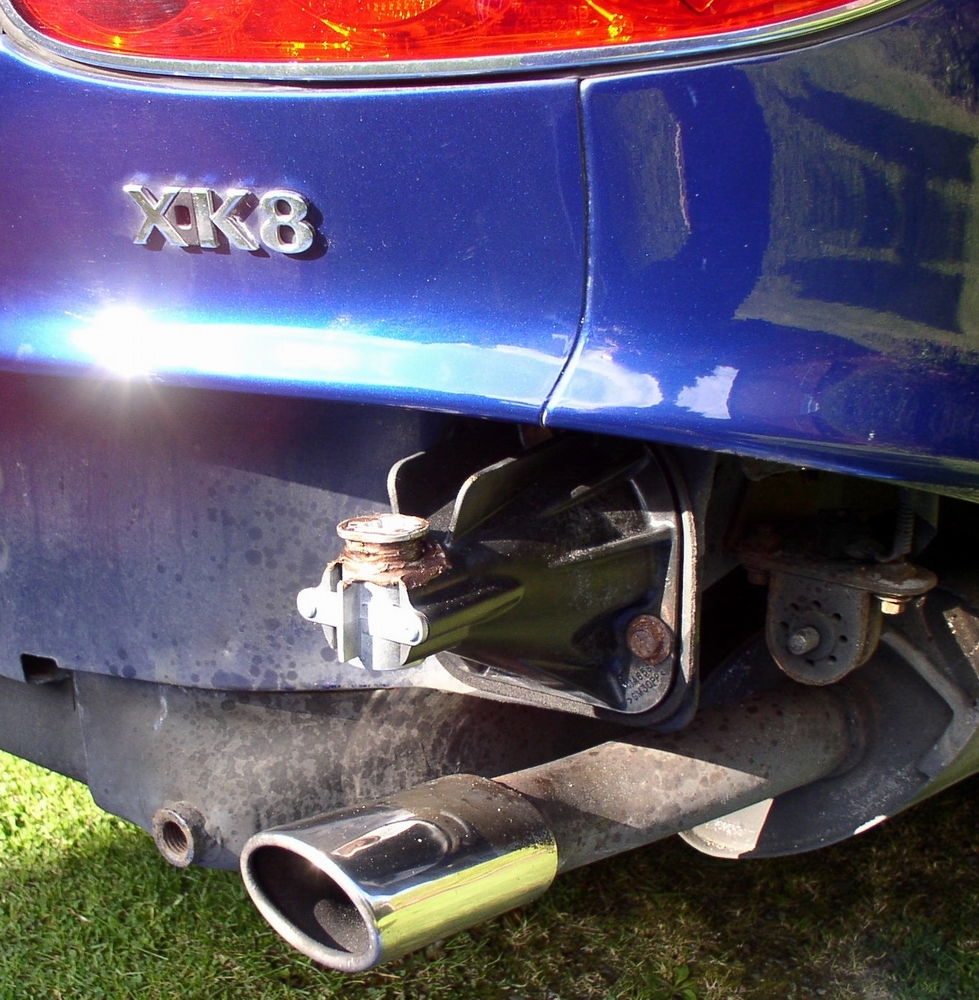

As always - very enterprising.
How are you planning to adjust the insert height? Using replacement brackets, I had to set them at nearly an inch on my 2001 XK8 to get the right clearance on the bumper gap:
Liberally coated in Coppaslip before finally refitting the bumper.
