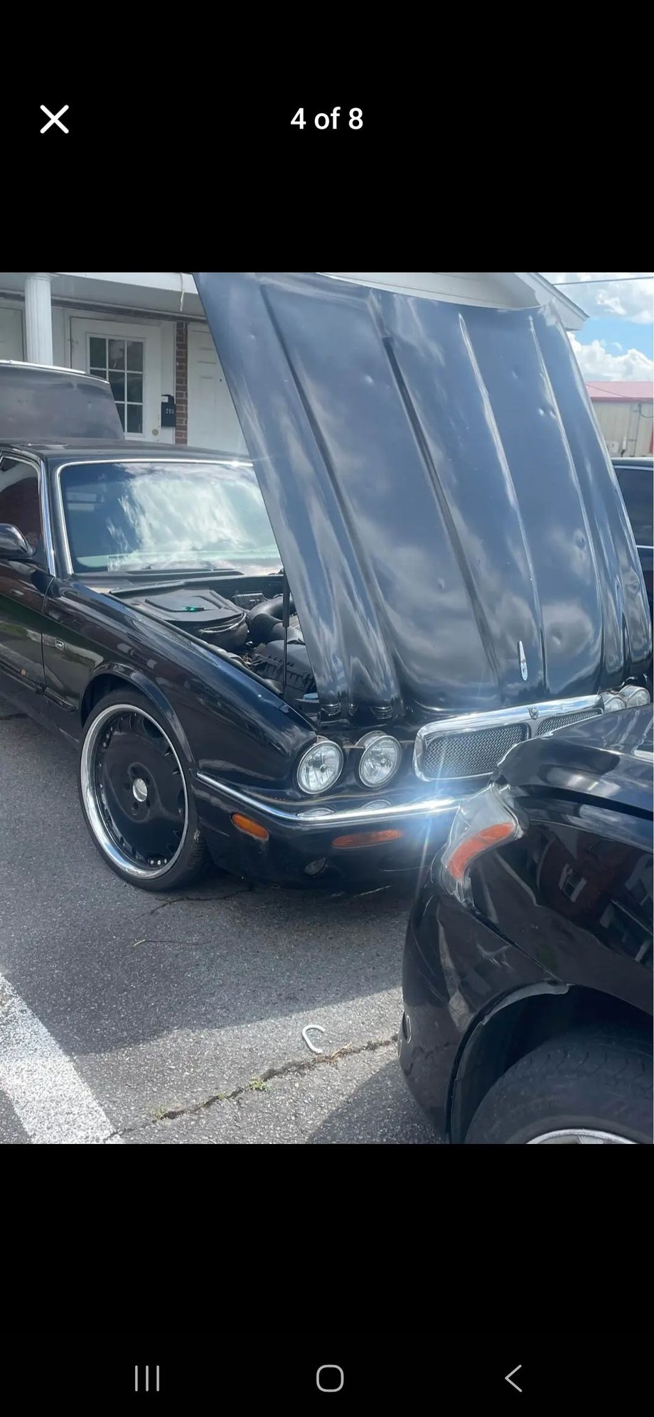

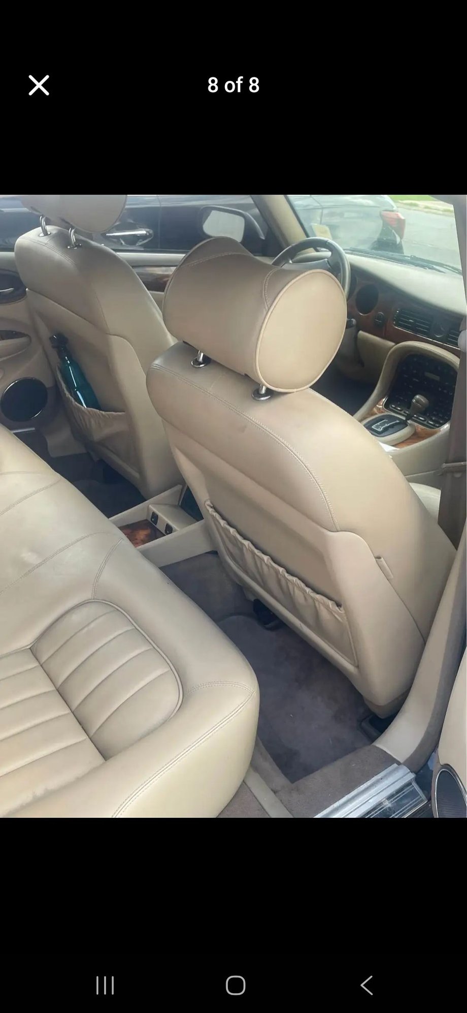

Hello, I was looking at buying a 2000 xj8. the seller claims all it needs is a starter. are there other things i should look at or be concerned about? the body is in good shape from what I've seen. I've never owned a Jag before but love the body style and just wandering if there are other things i need to be wary of. thank you nfor any feed back!

pictures of the car in question

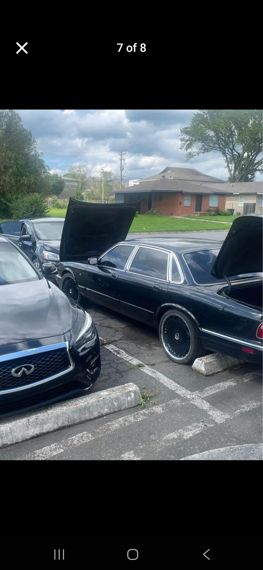

Mileage, price, service records? Given those wheels and tires, I would be very cautious. Maybe ask him to have an alternator/starter shop replace the starter, first; then talk. Without being able to drive it, hear the engine, this deal smells! At least check the OBD codes.

Indeed, if that's all it needs, then the seller would have done it already. Since you can't start it or test drive it, you have to assume that it needs: an engine, a transmission, a differential, four calipers, four shock absorbers, a fuel pump, an a/c compressor, a radiator, etc. You get the idea. Basically, you're buying a parts-car and only should be paying for what few parts you can confirm can be removed and re-sold. And that goes for any car that you can't run or test drive, not just Jaguars.
But other than timing chain and tensioners and the A-drum, these are known for needing at this age: new transmission valve body housing and main pressure regulator valve, ABS module, something we call the Octopus hose and the two suicide hoses under the intake manifold, thermostat tower, crossover pipe, auxiliary heater pump, shock mounts (well virtually ALL of the suspension bushes at this age), in-tank fuel pump, stretched door latch cable, stretched/broken hood latch cable, water pump, auto-dimming rearview mirror, headliner sagging, valve cover gaskets leaking, front and rear main seals leaking, oil galley plug leaking between the engine and transmission, disintegrated exterior trim and weatherstrip if its been out in the sun, buzzing/rattling stereo speakers, and probably dozens more common automotive geriatric conditions that I'm too senile myself to recall. It doesn't take very many of those items to add up to more than the car will ever be worth so be careful. Really, it'd be better to buy one at full retail from an enthusiast/Jaguar club member who has owned it for decades and already done each of those jobs one-by-one over time.

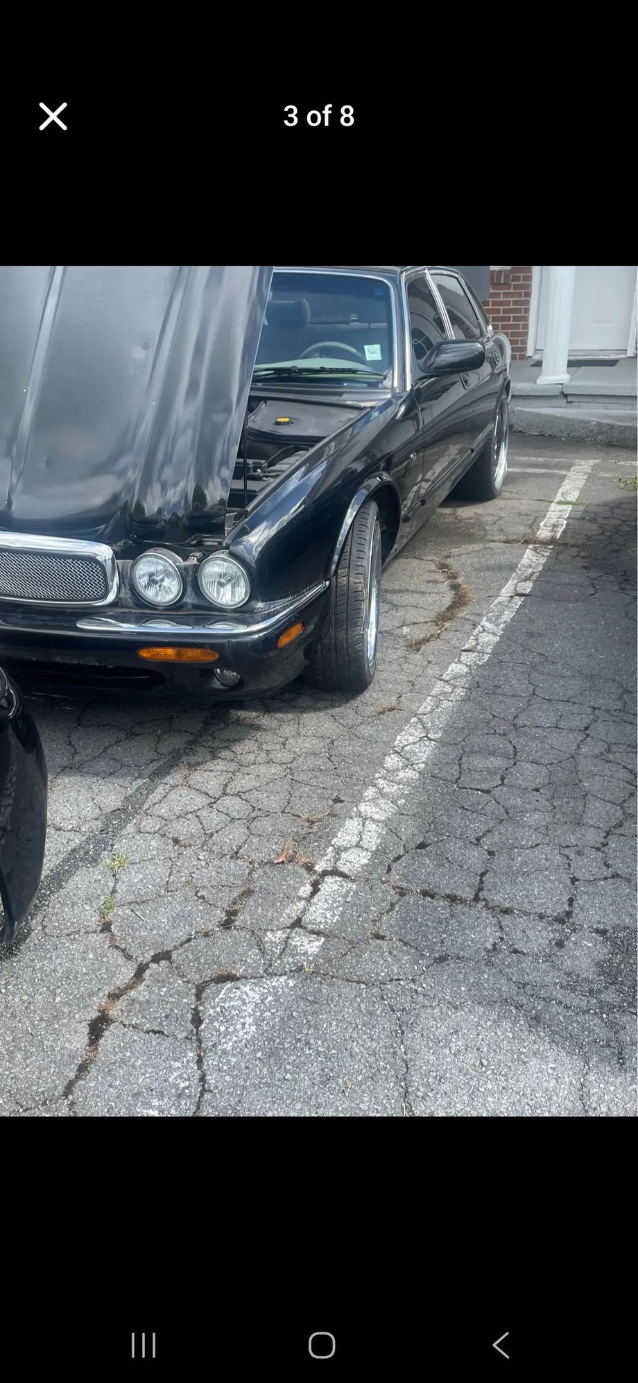

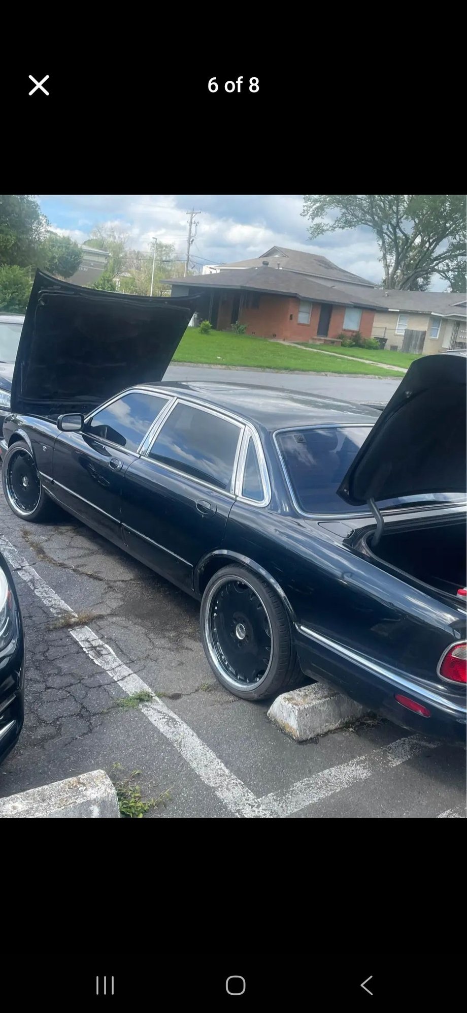

Oh My! The dents on this car would be a non-starter for me and the wheels make me wonder what else non-standard is going on. If it won't start and run, I'd personally pass and keep looking for a car in better condition. The advice offered in earlier posts are all valid.

Good eye! Yes pretty bad hail damage. Yes those rims are a red flag too but it is a cheap car.

The problem of course is that a non-running car with hall damage and a lack of records will ALWAYS be a cheap car no matter how much money gets spent trying to get it to work…
