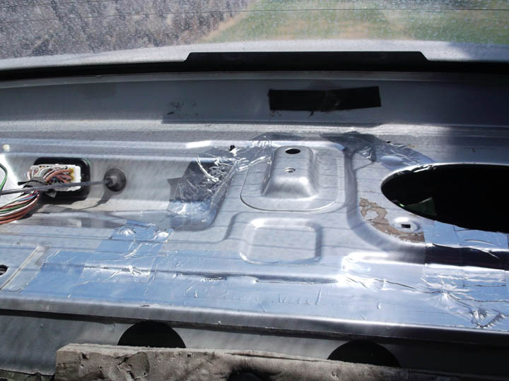

It was too hot for me to work on the car today so I thought I'd post some pics of yesterday's massacre.
Ugly - yes. The worst thing is if the next guy who does a fuel pump replace on this car doesn't notice the access panel until he's putting it all back together after doing it by the book.
I still haven't figured out what the heck they mean in the manual when they say "76.70.37" so to save the next guy from going through the manual page by page:
rear seat cushion pg 2166
rear seat backrest pg 2156
rear panel shelf pg 2086
Is there an index in the manual?
I did need to remove the seat belts, and you need a torx T50 bit for them.
The seat belts retracted and now I'm fighting to see how to pull them out. It could be that I've wrecked them. Lovely.
The red arrows in the last pic (I'm guessing) are where some earlier or maybe other than for USA seat belts attached. They are not used in my car.
I wet down some cardboard and put that on top of the tank for a flame arrestor. Later I wet down an old sheet, then put it in the washer on spin, and then threw that over the tank for additional safety. The Dremel makes plenty of sparks cutting the metal.
My trusty Dremel, about 5 years old and well used got hot and croaked with 4" left to cut so I got the red cheap unit for $20 and was surprised that it was actually quite good.
I use 1 1/2' fiberglass reinforced cut off wheels and I get a big bag for about $15. They break so I put small washers on each side (yellow arrow) and that helps them a bit. Still, they wear down pretty fast and I think I used 6 to make the total cut. The non-fiberglass reinforced wheels are useless and break when you look at them.
I left a "hinge" at the back. There was ample room to work on the pump.
If you cut out the piece completely and placed it on a donor car and cut out a piece with an additional 1" all around it you could make a nice panel.
To get the hoses off: I moved the clamps down off of the hoses. Then I used a flat screw driver and a hammer to loosen the ring, and once the pump assembly was loose I could lift it up and that gave me room to remove the hoses. I couldn't see any way of removing the hoses before I loosened that big ring, especially with older hoses that are a bit stiff.
The clamp type hose clamps are a pain and vise grips worked the best for me on them. The screw type hose clamps worked best with a 6 mm socket rather than a flat top screwdriver.
Inside the pump is held on with a 7 mm socket.
When the brackets were added I should have used 4 or more, but I only used 2.
The aluminum tape is neat stuff. It's very sticky like contact cement and conforms to shapes in a very easy to work with way.
With the tape added it was very strong, I really don't think you'd ever be able to tell once the car was put back together.
Once the panel is cut, I think if you practiced by the 3rd time you'd probably get a fuel pump replace down to 45 min without too much trouble.

Nice pictures. Does the access hatch need to be as big as that?
What was the problem with the fuel pump in the end? Was it the link lead or the pump?

As far as the hole size: I was guessing and I didn't know how much I'd have to tilt the pump assembly to get it out, so I decided to go a little big rather than have to cut some extra after.
Actually, if I were to redo it I don't think I would cut it smaller. There was pretty much the exact amount of clearance there to make it right. Any smaller would make it easier to get cut.
I only got cut on the hole in the tank which was extremely sharp.
You could even cut it bigger. Part of why I cut where I did was because of how convoluted the panel is.
If I were to redo it I'd try and make the curves a little nicer, but in reality it's a bit like sanding the 2x4's inside the walls of your house.
