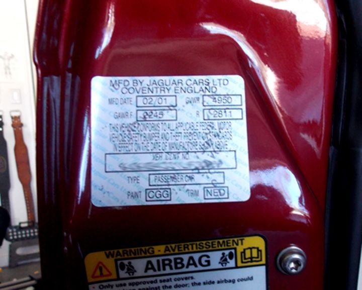

The VIN does give the year of manufacture, but a more accurate dating is found on the driver's door label in the top left-hand area.
February 2001

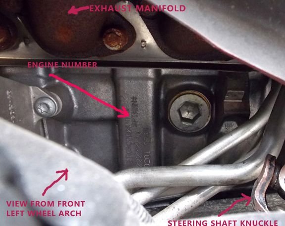

An even more accurate dating is found on the engine number, which is located on the left side of the block on the A27 engines........it can be viewed through the left-front wheel arch.
Engine number example 0105151050 01(year) 05(month) 15(day) 1050(time)
So that would be 2001, May, 15th at 10:50am
