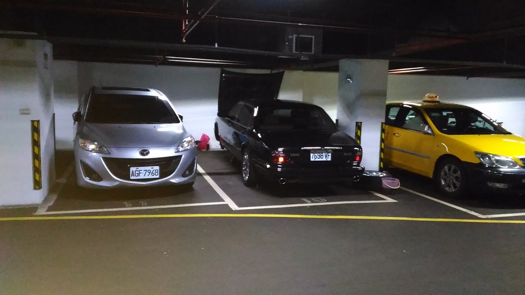

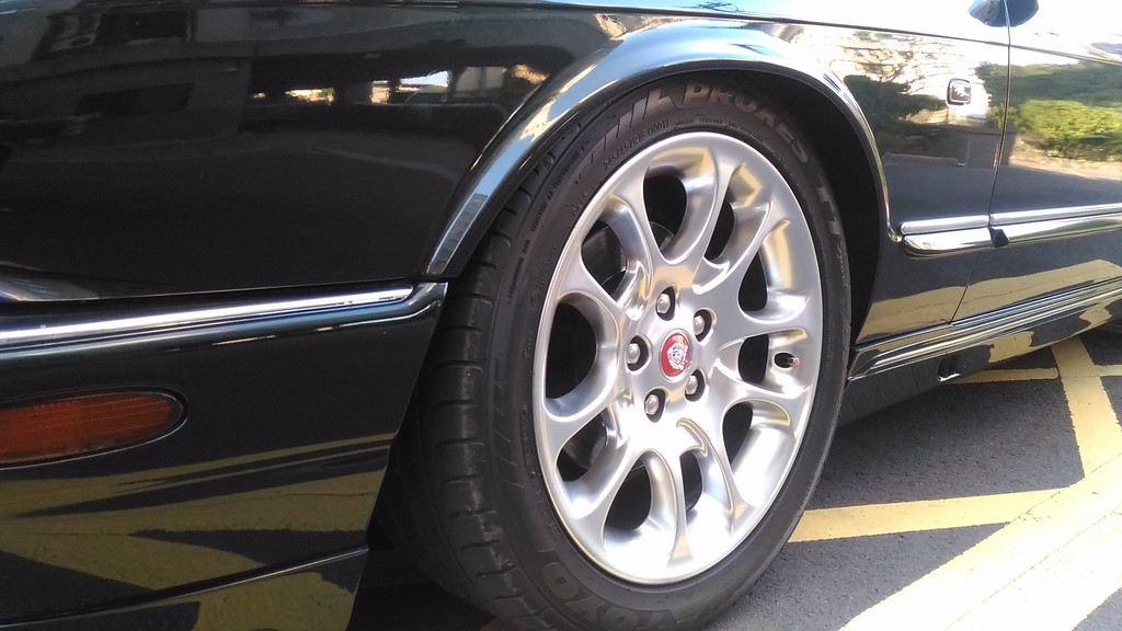

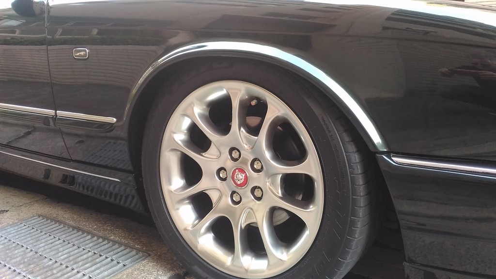

Lowering the car is on my mind for a long time, but this happened unintentional, and is a problem.
I had the car on the lifter this afternoon, to check the suspension and some other parts.
Nothing removed, nothing touched, wheels just loose hanging in the air as the car was lifted on its jacking points.
On the 10km back home, I scrapped several times, and upon arriving, I found both front wheels inside the wheel wells, some 1" deeper than yesterday, and exactly same on both sides.
So what the hell could have happened, and what should I look for first?
PS. In hindsight I should say that I already noticed (deep in my brain) the front dropping a bit, but never really noticeable, and I always blamed it on the looks of the body kit.
So it might have been going on for a while already, with the Apocalypse just now.

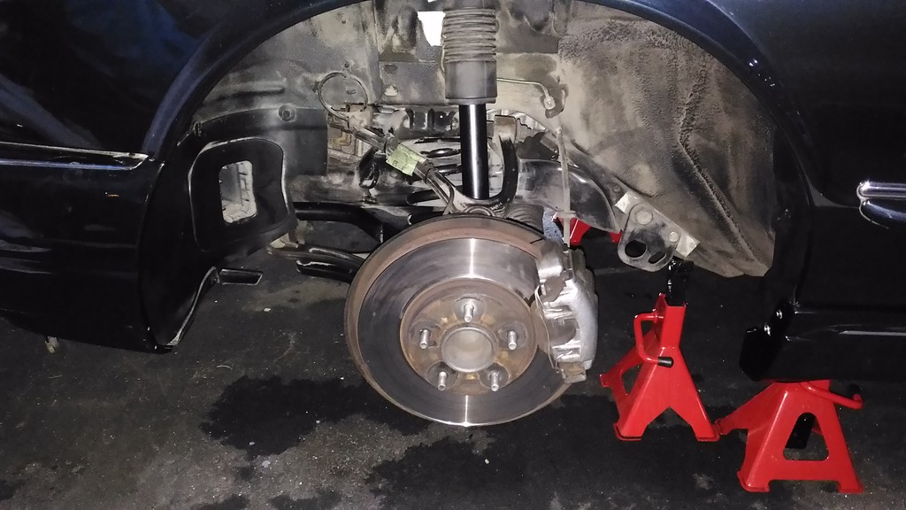

EDIT UPON RE-WATCHING YOUR PICTURES:
Did you drop the pans without the center tensioner, or is the pic only to demonstrate the guides?

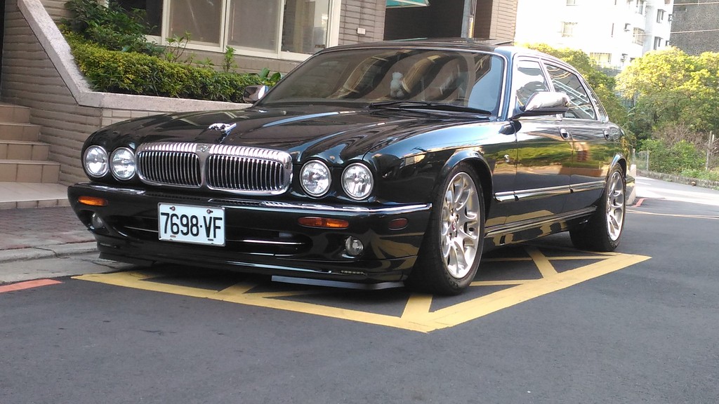

Well, I can officially confirm for now, and for anyone who will use this forum in the next 300 years, that shocks DO INFLUENCE ride height.
Just replaced both front shocks with new Bilstein comfort ones, and the problem is solved.
The car is not only back to the previous ride height, the 1cm difference between the left and right side (even before this happened) is gone too.
Stu was spot-on with his suggestion, one of the shocks had collapsed, I can push it in without much force, and it only extends to its neutral position after 5 minutes ...
The other one is slightly better, but not much.
For the rest all looks rather good, no rust at all.
Will spend some more time cleaning this summer when I do the rest of the suspension, and I am sure can bring it back to new with just cleaning.

2. Daim: you might not have read my edit above, but upon re-watching your pictures, did you drop the pans without the center tensioner, or is the pic only to demonstrate the guides?
Now I got 2 questions left:
1. My front springs have a red paint mark on them, anyone know what specific model these were for?
There are no guides in the picture Just 3x threaded rod with an M10 thread. Nothing else. I didn't use any middle "tensioner" to install the springs.
