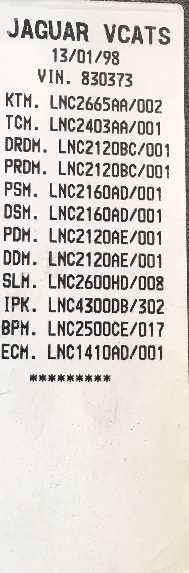

Aquifer, the only way to know for sure if your car originally came with CATS is to look at the VCATS label in the trunk. My 98’ (now my daughters car) didn’t list CATS on the VCATS label. I’ll have a look at hers this weekend when she’s home. I have a feeling they were added on separate from the factory but of course I can’t be for certain if it was port or dealership installed.

87LC2, Remove the spare tire cover and lift up the left side carpet. It’s a large rectangular white sticker with all your information.

Not trying to hijack the thread, I really think this question will help both of us understand if our cars have CATS or not. Here is a picture of mine. Which, if any, of these lines would indicate CATS? And 87LC2, I recommend taking a picture of your VCATS label so you don’t have to remove the spare tire each time! I’ve referred to mine many times over the years for various reasons related to problem solving.

Aquifer, even though your not the OP, I don’t think your hijacking this thread at all.
This is from my 03’ SV8. The notable difference from our labels is on yours the ‘ADM’ (Adaptive Dampening Module) is not listed.
