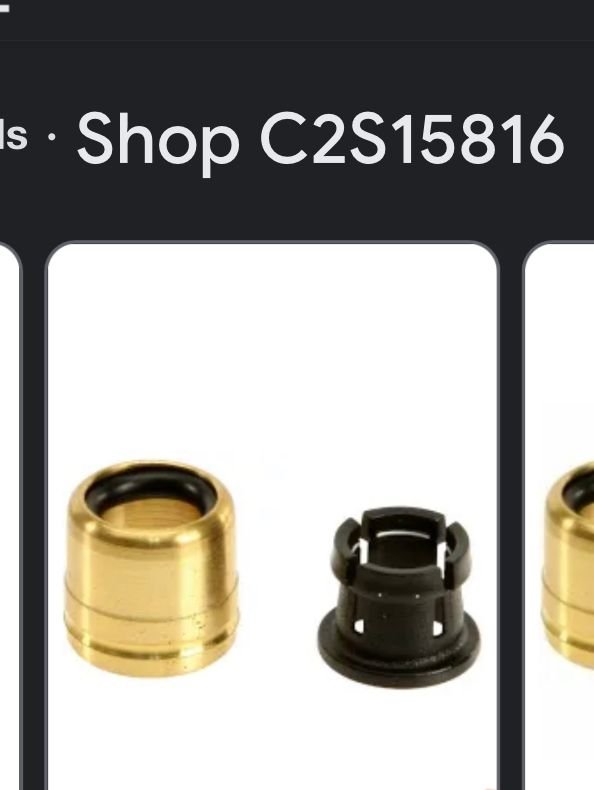

I attacked everything I could access with brake cleaner with no luck. I suspect the culprit could be the vacuum line at the P/S base of the throttle body that feeds the brake booster - when assembling the beast I remember wondering if the o-ring in there is really the only thing holding/sealing that line. BTW is that o-ring replaceable (it's original as far as I know)? Unfortunately this motor is stuffed into a Mark 2 and the area under the TB is virtually inaccessible. I'll have to remove the bonnet, and since there's no way to maneuver an aerosol can down there I'll probably have to remove the line, plug the opening and look for a change in the LTFT. I assume repeating the 15 mile loop I recorded earlier will be enough time for any change to show up? Let me know if there's another way to do this, as I'm not sure if running 15 miles without vacuum assist on the brakes makes any sense.

There is a breather tube running under the intake and plugs into the front left cam cover on one end, then it
Tee's into the throttle body and continues past the throttle body. That particular tube is very susceptible to
cracking and could be the source of a leak. You might also look at the brake assist vacuum line plugs
on the right side of the throttle body. There are little “O” rings inside that fitting that have been known to
crack and allow a vacuum leak. It may be wise to procure a smoke machine at some point.

This is the connector on the P/S under the TB that joins your brake booster pipe to the lower charger intake. Disregard the actual brass collar because you don’t need to replace it. The very specific size o ring and that plastic quick connect will likely need replaced. I would not drive the car without vacuum assist. I’m not saying this is your problem but, they are prone to vacuum leaks from this.

It is repairable, ...I don't know if its still available, but it is repairable.

That was the problem I had with my 06. I just sealed it with RTV because I didn't know how it came apart at that time.

Addicted and HH - looking at the pics of the adapter, I don't even recall the plastic locking device being present. It could have been in the TB but I'm thinking my tube may be retained solely by the o-ring on the brass collar. The part is widely available so I'll order one and start removing stuff to access the area.
