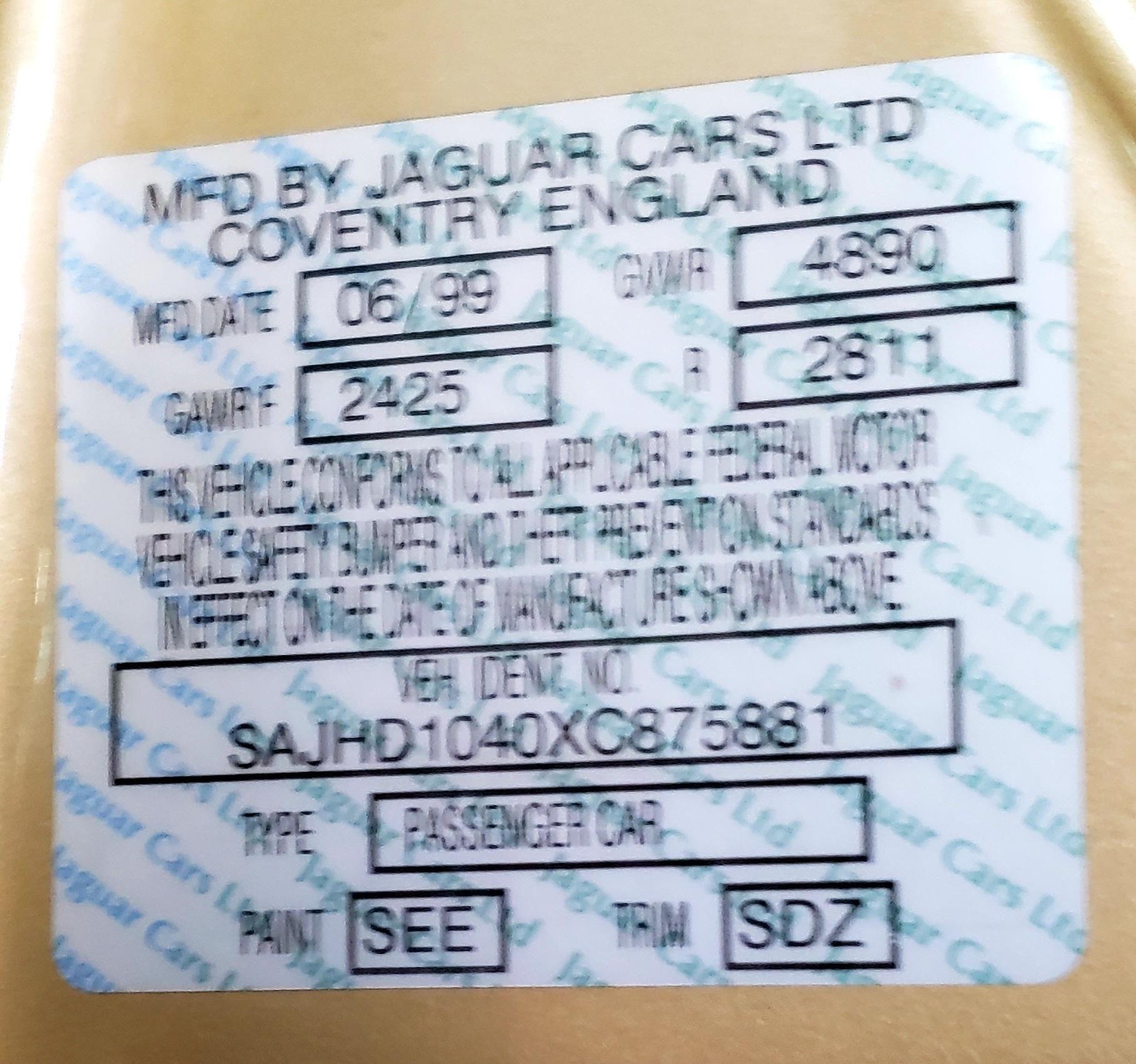

Can't seem to find ANY info on this color. The car is rumored to be one from a dealership used as a show/courtesy car for the 2000 model year​.
Any help would be greatly appreciated!

topaz but they screwed up and put two Es?

Parts Catalogue 'A' pages for you.
The car is actually a 1999MY car if it is in North America.
F00001 is listed as the VIN beginning the 2000MY X308 sedans.

Someone must have 'screwed-up' as I have NEVER seen SEE as a paint code.

I found the color is Mid Beige Met. Here is the link to the page.
https://www.paintcolourchart.com/car...036jagsee.html
