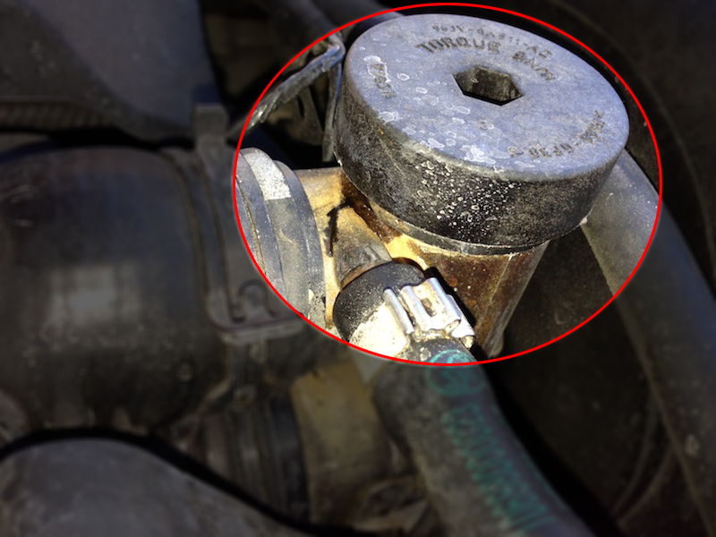

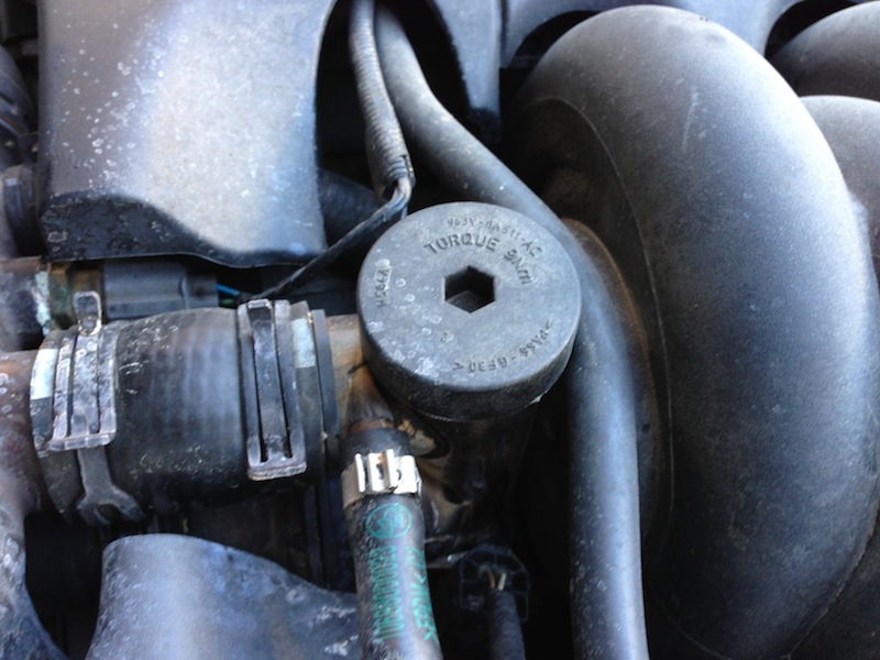

I have a 2001 Jaguar XJ8 Vanden Plas and I'm experiencing a coolant leak just beneath this cap. Could anybody give any insight on what may be causing this and if the cap is able to come off to further inspect?
Thank you in advance.

If I had to hazard a guess it looks like your thermostat tower is plastic and has developed a crack. You can take the cap off, no problem.

It's time to change to an aluminum tower. There is lots of information on this and the XK8 forum if you do a search.

Thank you. I'll have to order the aluminum thermostat housing and get this repaired ASAP.
