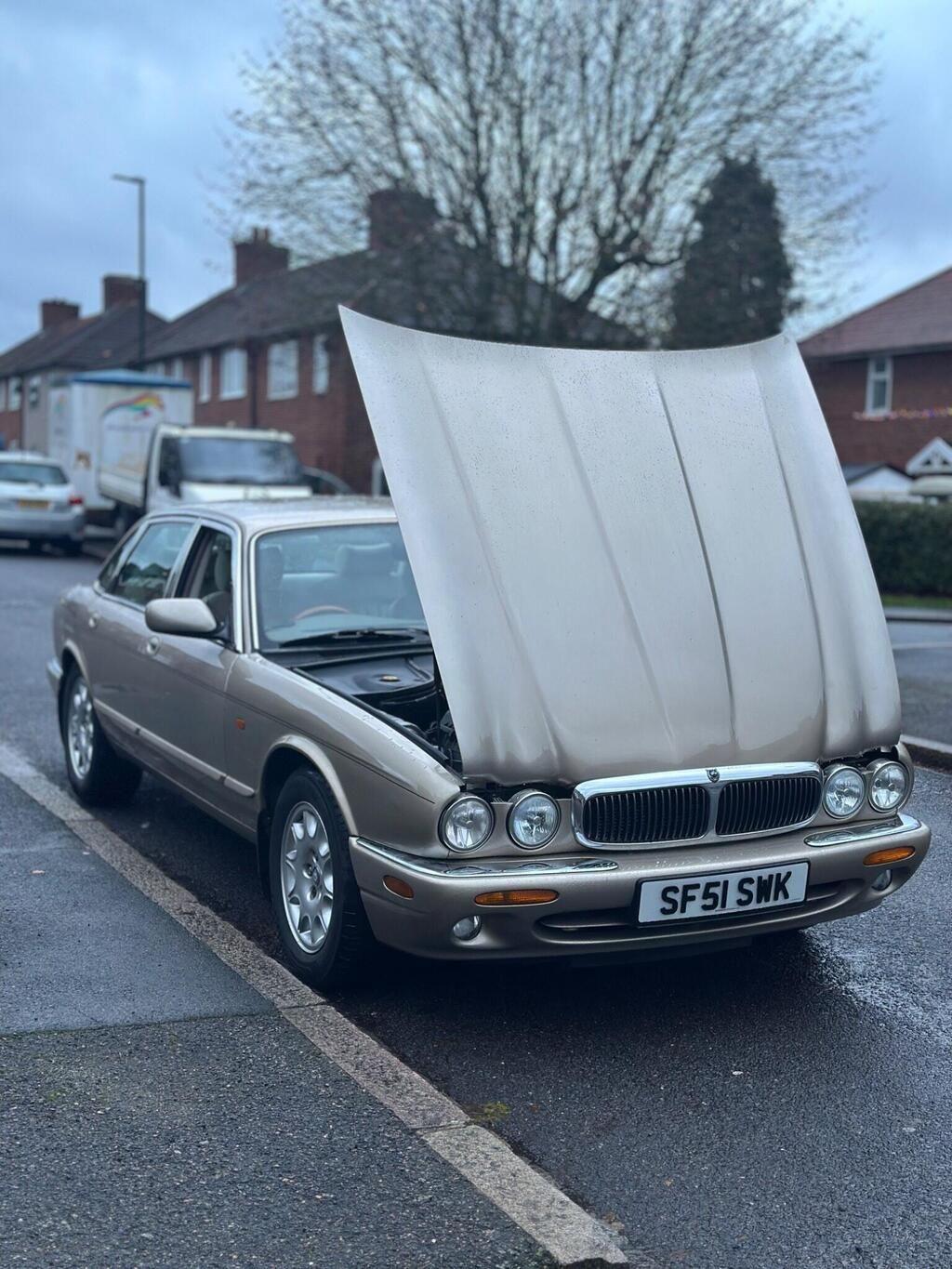

Hey guys, hope you all are well,
Ive always been a fan of the big cats, particularly the x308s, and I was wondering what would they be like to live with as a main car. Im currently in a straight 6 BMW of similar vintage, would the jaguar be better or worse on the wallet in regards to servicing and reliability? Im looking at model year 2002 and late 2001, so as to dodge the tensioner and nikasil issues entirely, which leaves me with the autobox as the only real failure point (or so ive heard, please correct me if im wrong). Would it be more or less reliable than similar aged Germans? How much should I expect to pay per year? how easy is it to maneuver in city streets? and more importantly: how far will my jaw drop when I see it in the parking lot?
Im based in the southeast UK with semi-regular trips into Central London for work
Any of you take your big cats out daily? how many miles do you do and how do they hold up?
Thanks to all of you !
A lil something i found on autotrader for <3k
