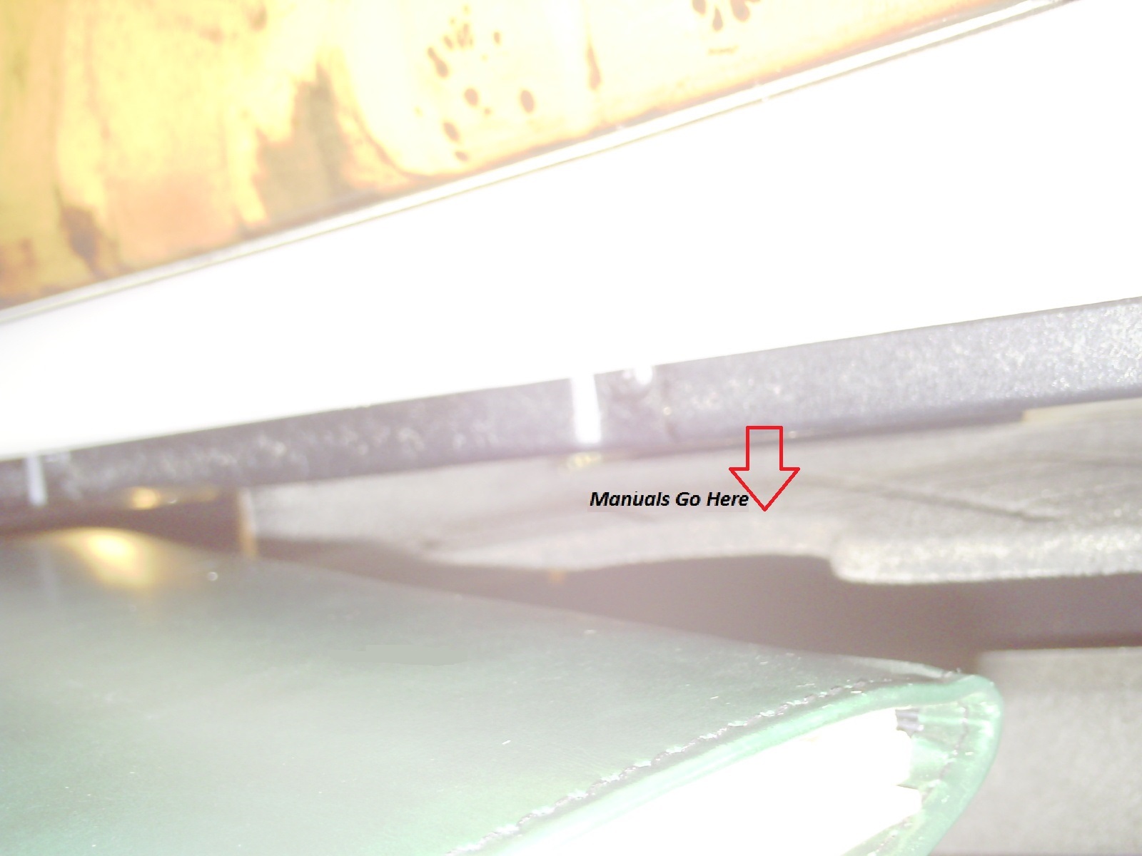

Also, if you're like me, and didn't know this, there's a little shelf above the main box that doesn't move down with the box when you open it. It's secured (rather loosely) from the ceiling of the compartment. This little shelf I assume is a owners manual slot. Without weight in the slot, mine rattles against the ceiling. There's probably a way to tighten it up, but a quick fix is: insert owners manuals (or a fat wad of something else) back into slot to shore up the play, effectively eliminating the rattle. (Third pic).
All quiet now. Give it a look on yours if you have the same %$&*#@ rattle.
