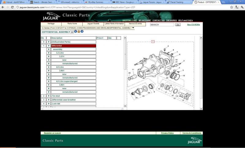

Per, the 3.2 is 3.27:1 ratio, the 4.0na and 4.0sc are 3.06:1 if you fit the 3.27 your car might not work as the trans module isn't programmed for that ratio.

Aha, ok, I was told by Avos that all used the same but the ones for the Mexican market. OK, so that should as far as I understand mean that I can use one from a 4.0 non SC model! thats good news as I got contact with a person that have several units for sale, but quoted 400£ for just a XJR8 diff, compared to 120£ for a normal one....
