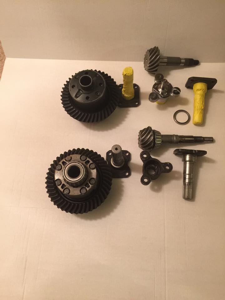

Eric, I've just done this. I wouldn't advise using the weedy stock 14 HU unit.
Ive used a 15 HU former power lock- but went to 3.07 gears for a Dana 44, I had splined shafts and flanges made up to work with the Jaguar X308 jurid coupling.
The Dana 44 is very strong- its a 8.5 inch unit.
The stock 15 HU GKN diff uses 10 input splines and 19 output splines.
The Dana 44 utlises a 26 spline for input and I went for a 30 spline output. This opened up the option to use a Torsen T2R LSD carrier.
Above shows the new Dana 44 and amended components- below in this picture shows the older GKN Jaguar 15 HU components.
The shafts are 48 HRC (hardness). The flange adaptors have been designed and made to interface onto the Jaguar Jurid coupling without potential for whirl. The bearings used are a combination of those compatible with a Dana 44 and those that are compatible with the GKN Jaguar 15HU differential.
The new set up should be ample in terms of handling a whole ton of Bhp.
