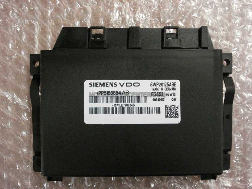

What's the deal with the upgraded torque converter the Mopar guy's are posting about?
Mopar Performance P5153726 Mopar Performance Torque Converters
Part number: P5153726
That alone may help.
From the looks of the TCU it's a Siemens unit Mopar got ahold of...

The torque converter isn't really going to help since the goal is to get power to both rear wheels. The SC cars already have the torque way down low.
