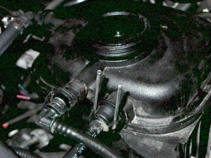

I had to replace mine. You need to remove the intake manifold to replace it. Actually, it's not as hard as you might think. The intake manifold seals will need to be replaced, and I also replaced the 2 heater hoses that go under the intake manifold and cleaned the throttle body and all the electrical connections to the throttle body. The hardest part is noteing, photoing or remembering where all the plugs and hoses go and finding the proper tool to disconnect the fuel lines. The fuel lines need a "top hat" type disconnect that slides in and lets the fuel lines come apart. Also, the norma connectors - like on the part load breather, have a trick to getting them apart. You cannot just squeeze and pull. I'll try and post a photo later. But, anyway, it's all in the technique as opposed to brute force. Plastic and small sockets and o-rings, no sealer.
Old 01-05-2012, 09:15 AM
JimmyL's Avatar
Join Date: Oct 2008
Location: Virginia Beach, VA
Posts: 1,771
Received 402 Likes on 299 Posts
Here it is :
I used two nails, thin brads about 2 inches long and stuck them in the slots on the
sides perpendicular to the hose and squeezed them a little while
pulling the hoses off. This is like what the C-shaped tool would
do. They go back on with a nice reassuring click.
