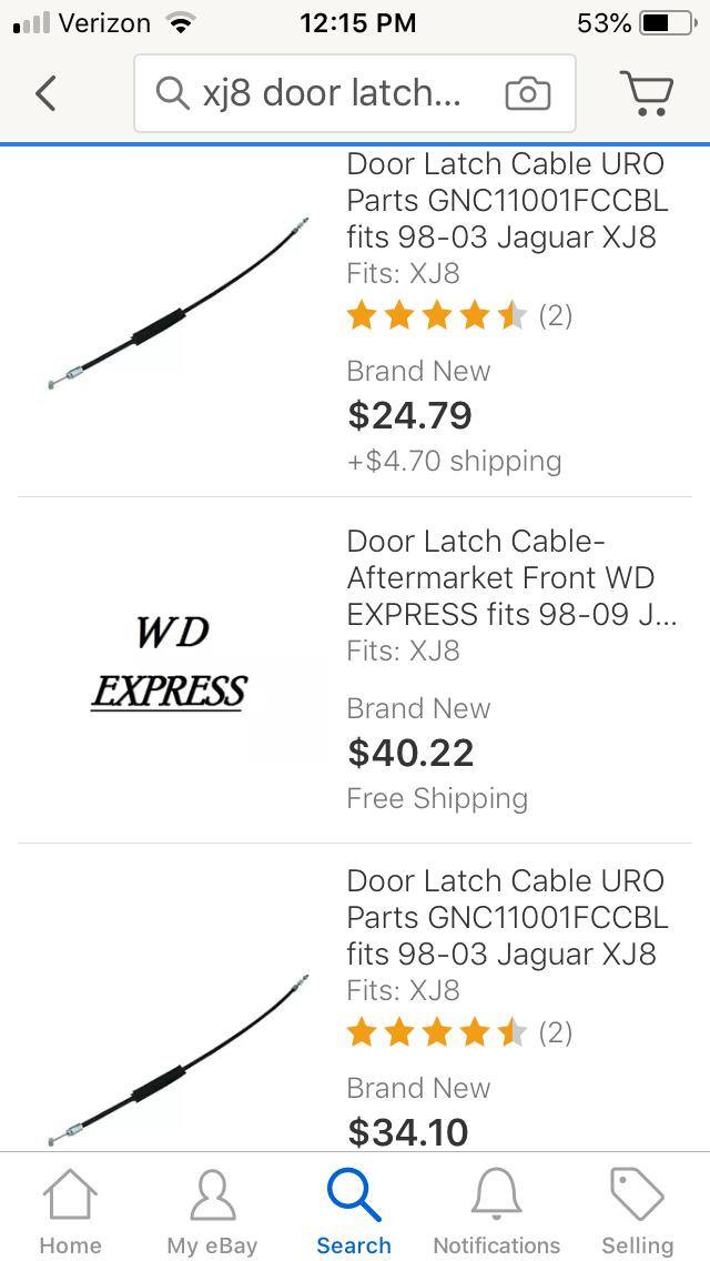

More then likely it’s the cable acting up, already replaced two on my XJR had to replace the similar setup on my old Lincoln LS, cables are readily available on Ebay for around $35.
