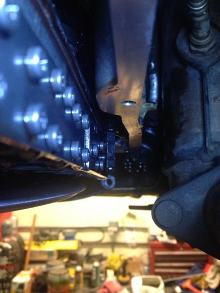

In case anyone was wondering, kinda as am I, the 17.98 eBay dipstick is too long for the tube, however it stops I have taken two pictures with the pan off on the lift to show how far it does go down. The first picture is from the rear of the car facing forward you can see the filter hanging down, my phone is essentially resting along side the valve body.
The second picture is a similar image however from the front of the car to the back. You can see the low temperature indicator on the stick.
Does anyone have a rough idea, is this where its supposed to be or does it have to drop down farther seems to me based of other vehicles as if it may be about right considering its supposed to take about 4 quarts.

The important thing on the dipstick for the MB 722 tranny is the indication area. The lengh of the rest is not important.
Put the dipstick in the tube and push it to the bottom of the oil pan.
To bring the oil stand in the correct level, you have to warm up the transmission ( about 80°C ) then push it into drive and hold the brake, now you can see the real level of oil.
Hope it helps.

This dipstick will not go into the pan any farther than it currently is. I also have the one for the Chrysler transmissions in my shop as well was going to try that one out tonight. The bottom of the pan seems wrong, there has never been a car in my history of working on cars (about 30 years) that it checks from the very bottom of the pan. I have read that on here and that seems to be the accepted means and no one is having problems so I guess it is just another great case of engineers being too smart for their own good.
According to the workshop manual it says to cycle the trans from park to drive, drive to reverse, and lastly reverse to park to check the fluid.

The dipstick shouldn't go any further (certainly not to the bottom of the pan!), and by the looks of if you have the right dipstick. You can see a thicker ring (squarish actually) on the upper side of the black plastic where it will stop in the box to keep it at the right level.
The dispstick in aardvark64 link doesn't seem right to me.
Here is how it should look:

Yah that square part is what made it stop I know because I ground it off to check now it goes to the bottom of the pan. Almost every person on here said its supposed to go to the bottom of the pan. It took about 5 liters total approximately and seems to be working well. I may order the actual Jaguar one from the link above and check it with that.
Also may purchase another one of the Benz ones with an intact square stop. So many varying opinions and only one thing in the workshop manual which is check with the Jaguar dipstick.
