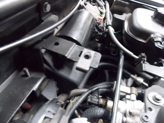

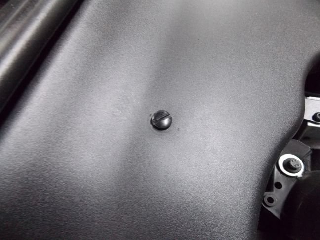

Damn it, I broke my quarter turn fastener for the engine bay centre trim cover. What is the correct term for this item, and or part number. Alternatively, what would do a good equivalent job.
This is what it looks like:
and this is where it goes:
Still works, of a fashion, but I'd rather find a new one.

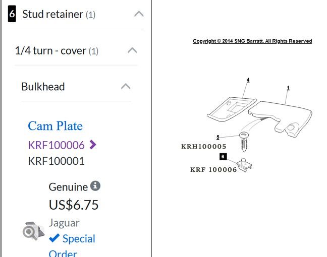

KRH100003, superseded by KRH100005.

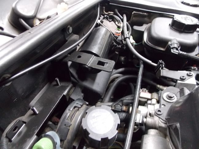

I don't get it.... My XJR has that fastener, but it doesn't attach to anything under it, and looking up that part number - it doesn't come with the locking piece underneath.....
What's it supposed to do? And how do you get the locking piece underneath?

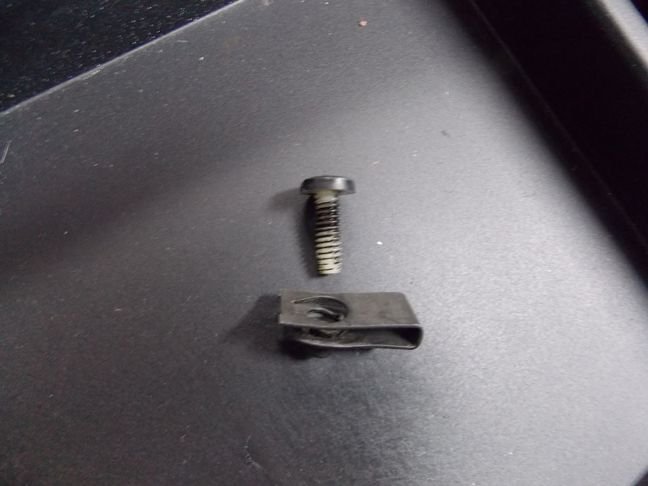

Part # KRF100006 clips into the square retainer hole in the support bracket. Screw KRH100005 slots into the retainer to hold the cover in place.
If you don't have the original retainer clip, you can replace it with a common retainer clip from any TrueValue or Ace Hardware store, and a matching threaded screw. I used a threaded metal retainer and a nylon screw, which I sprayed satin black.

I found these by accident at Ace Hardware if I remember right. They are steel threaded, and I used a blind clip underneath like what CK showed above. These were gloss black, so I scuffed them and shot a few coats of satin black paint on them. No tools needed to remove the panels!
