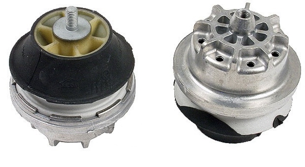

I know this is little old thread.
Could any help me identify the difference between these two?
and why the price is so different?
SNG Barratt - The Ultimate Jaguar Parts Specialist
Regards
Regards
I suppose the first one is aftermarket, the second one is OEM.
You are correct!
I've contacted SNG and they've confirmed this is the case.
I also did ask if there are any difference, They said "OEM parts have better finish with an improved housing..."
I've ordered after market ones so will let you guys know how it differ from the OEM later!
