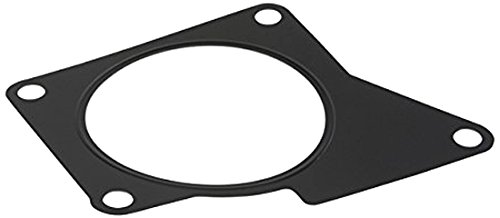

I have never used a metal gasket but I don't see any reason why it shouldn't work. It is important to torque the bolts properly and it's not difficult to damage the gasket during assembly.
So after confirmation that the non-metal gasket is the correct one I promptly placed an order and it's arriving tomorrow. Then I started looking at the pictures.
The bolt holes don't "appear" to be the same. The metal gasket has one bolt way off to an extended corner. The metal one is what I installed last time and the holes lined up with my throttle body holes. It "appears" as though the non-metal gasket has an offset hole, but not by nearly as much. Should I be concerned?
I called the Jaguar dealer again. I gave him my VIN number and asked him to please verify the part number for the throttle body gasket. He confirmed the green one pictured above is the correct gasket.
There is just no way it will fit though. Although mine is NOT an air assisted throttle body, it has the same design and shape as the air assisted throttle body according to the Heritage website. I ordered both gaskets and will send back the incorrect one. I wish motorcarman would happen across this thread, he would probably have run into this before.
The metal gasket won't be here until Wednesday, so if the paper one does not fit tomorrow (which I feel confident it won't), then my car will be down for another day after I take it apart.

Both gaskets got here today. The one listed by the Jaguar dealer and most websites, the green paper one, is not even a close fit. It does not line up at all.
I replaced the gasket. The one on there was completely flat, crushed, probably as it should be after installation. The new one still had a noticeable ridge. I torqued the throttle body down onto the new gasket using my torque wrench; about 15 ft lbs.
No noticeable immediate change in fuel trims. When I spray in that area I still get a negative spike in fuel trims, but it's a bit less. Spraying directly onto the sealing edge of the throttle body has no effect on trims, so the new gasket is working fine. If I spray the connection points for the EGR valve nothing changes. If I spray the body of the EGR valve, the black cylindrical portion, then it spikes a little negative again. Could the EGR valve be hopelessly cracked? Man I hate to buy a new one!
Obviously I'll be sending the paper gasket back, question answered...
