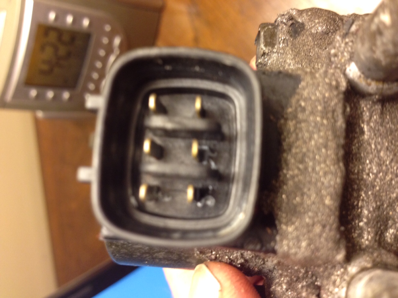

The only openings inside the electrical connection are right around the prongs themselves. The plug goes in flush to the bottom so I'm at a loss as to how to seal those prong holes.
Forgive the fuzzy picture, but you can see I have to somehow seal those openings without compromising the electrical prong itself and still allowing the plug to slide all the way flush into the connector receptacle.
I started to use a pick with RTV on the tip. It just didn't seem to work without gunking everything up inside.

does the egr block off route not appeal to you?
you might try plugging the whole thing together
then wrapping the two connectors in self sealing
tape. don't forget that the smoke will also push
past the harness connector to the entry point of
the wires to the connector.
Is there a rubber seal inside the electrical connector around the pins? If so, could you use a pick or needle to pry the seal out, inject some RTV sealant as far down the terminal pins as you can, replace the seal to push the RTV further down the pins and hopefully seal all the openings, then use Q-tip swabs (cotton buds to our U.K. friends) to clean any residual RTV off the pins?

I tried working some RTV in there, but when I smoke tested it again it made very little difference.
I tried the self-sealing tape like plums recommended, I have always liked that stuff. I wrapped from the EGR valve all the way down to the sheathed line from the engine harness. It appeared to make a perfect seal over the electrical connection, I was very optimistic.
