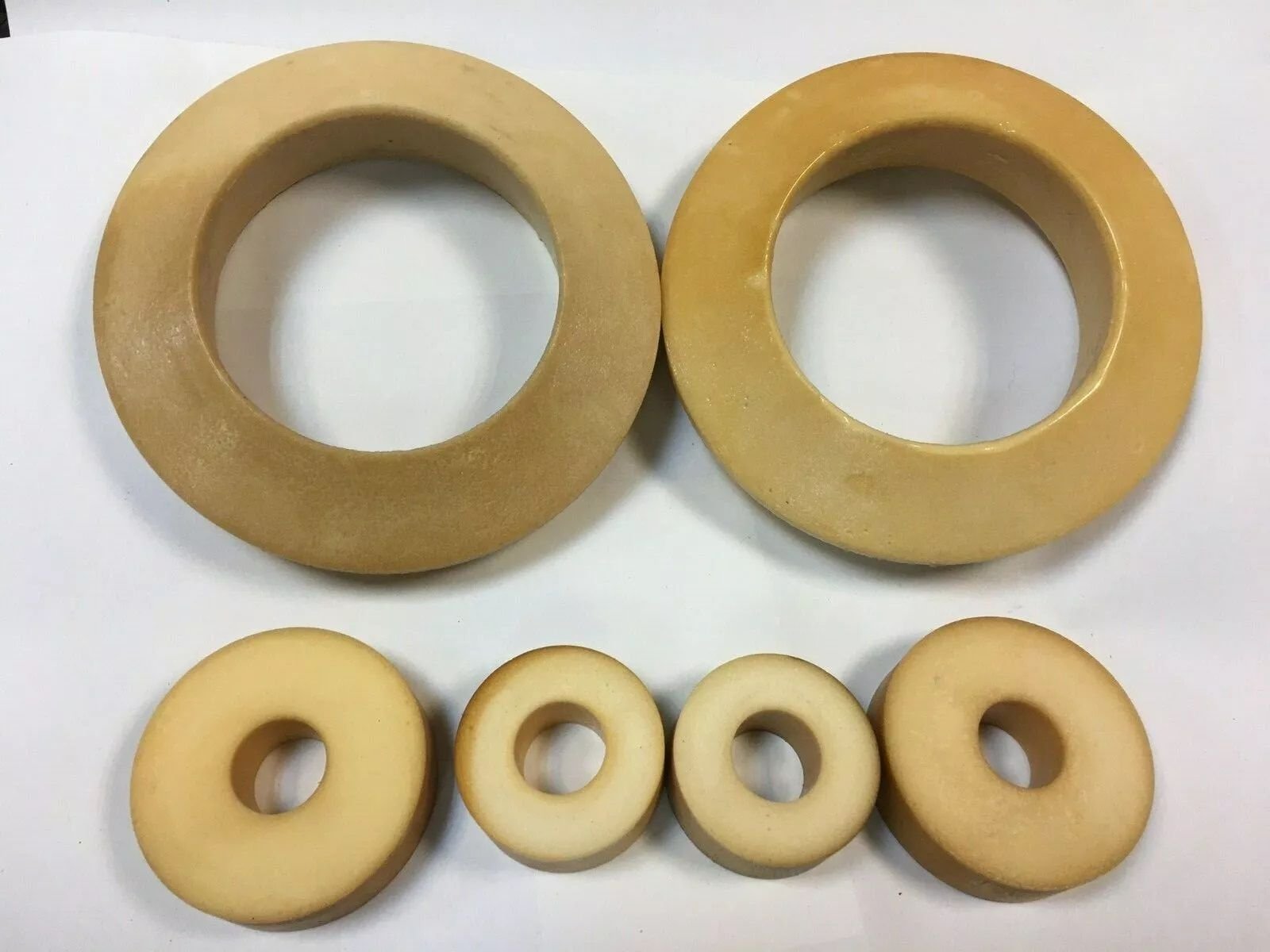

Reg. knocking sound from the back of the car:
On my X308 the annoying banging sound came from the rear shock lower bushes - I swapped them with my hydraulic press - and while I was there, I also swapped the "REAR SHOCK ABSORBER SUSPENSION BUSHING BUFFER", where I actually did not buy the expensive original parts, but I made something up using generic rubber or PU parts.
This is a picture of the original replacement parts:
On my Fairlane the annoying banging sounds were actually caused by those worn out parts in the picture above (obviously the Fairlane version).

I know the knocking sound from the back, which I also have. I already got the bushings and buffers for the rear shock absorbers, which I will change at a later date.
