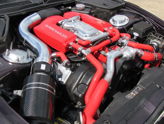

From the finish you describe I would say a previous owner has done it, on a 2003 I would expected to see a matt darkish grey finish from factory. The problem you get is the coolers are aluminium and painted straight on, no etch finish was applied first so over a period time with heat etc the paint peels off.
The only way to make to make it good again is to re do it...... I do a lot of engine bays!
Attached Thumbnails Finish on Charge Cooler / Intercooler-img_1501a.jpg
