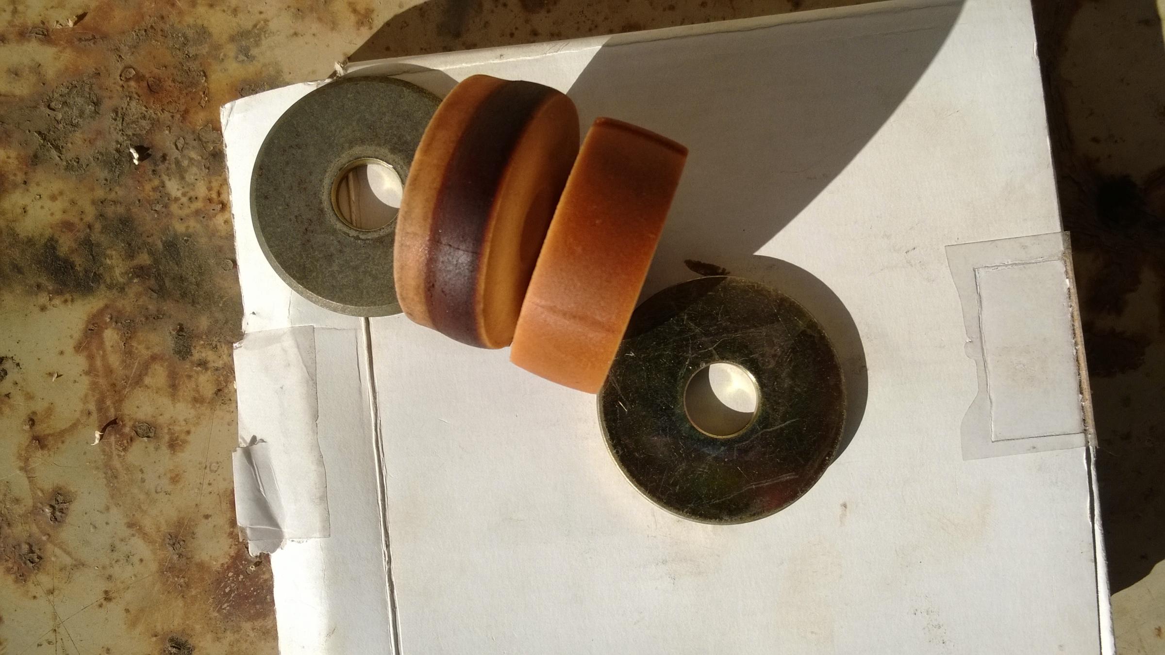

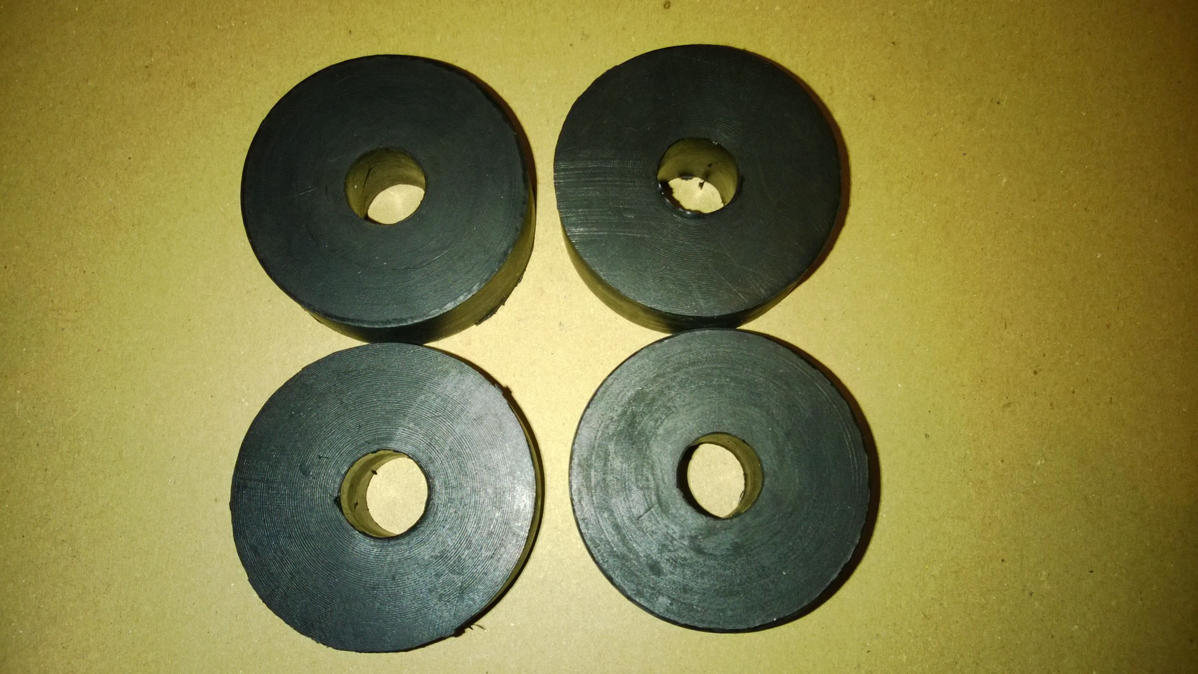

Old Nov 15, 2013 | 03:24 PM
flay's Avatar
Posts: 365
Likes: 71
From: Romania
As I couldn't find those bushes in Europe, I found somebody making this kind of stuff, and today I received the first 8 pieces (for me and a friend of mine). They are made of rubber, no polyurethane.
Tomorrow I will fit them, a lot of money saved.
Attached Thumbnails front shock upper bushings-wp_20131115_002.jpg   front shock upper bushings-wp_20131115_003.jpg   front shock upper bushings-old-ones-side-view.jpg
