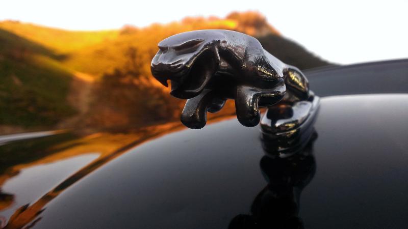

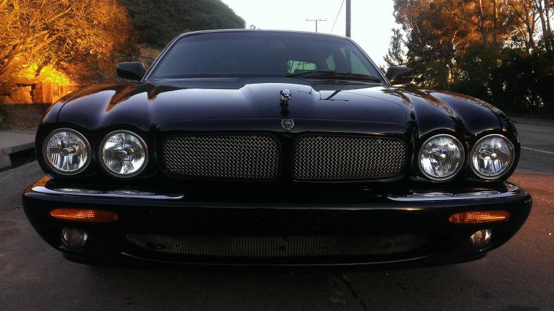

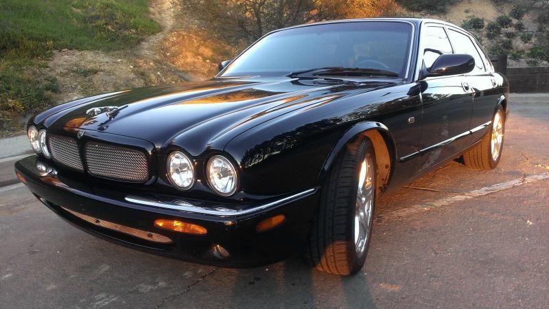

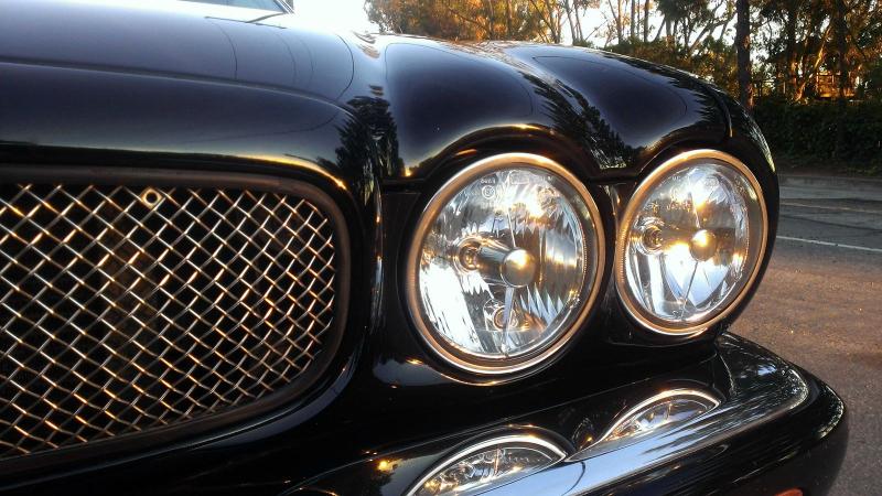

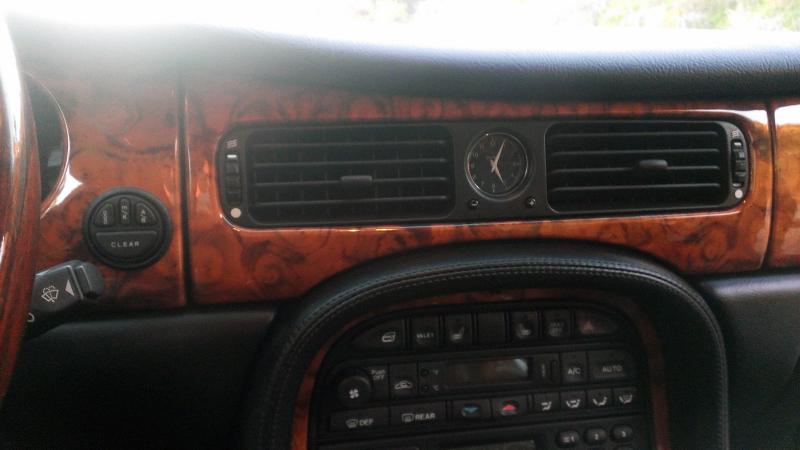

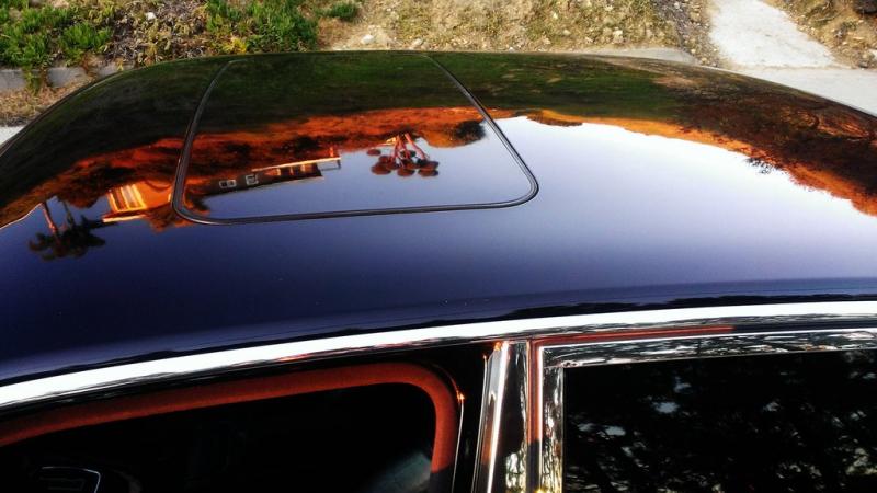

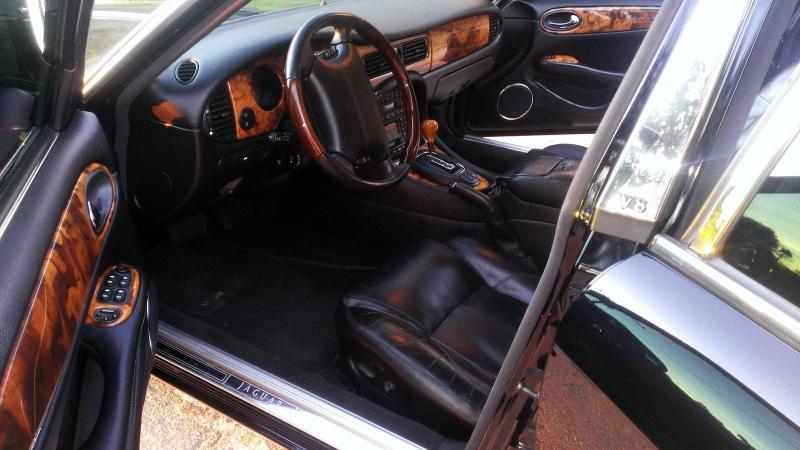

Without further ado, here is the 'new' Jag...
She is a real beauty! The pictures really do little justice to just how sleek, comfortable, and luxurious this beast really is...
