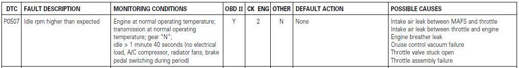

Here are the definitions and published possible causes of the codes you scanned from the 1998 DTC Summaries, which I am attaching.
The P0507 certainly suggests a significant air leak. Regarding the use of a smoke machine, I don't know how experienced you are, but the first thing to know is that some of the less-expensive machines are regulated to 1 psi output for safe use in testing EVAP systems. To test the air intake on your car, 10 psi or even higher may be necessary to find certain leaks.

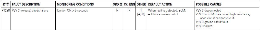

P1238 suggests the cruise control Vacuum Switching/Solenoid Valve 3 (a.k.a. Solenoid Vacuum Valve) is disconnected or there is a problem with its wiring. Probably nothing to do with your engine performance unless the vacuum hose is detached, constituting a leak.
I just went and fixed all of those t fittings with new ones so hopefully isn’t that but I’ll definitely have to double check.

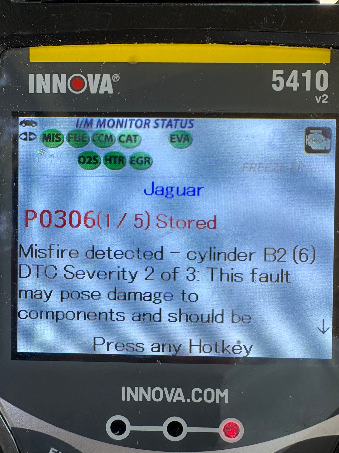

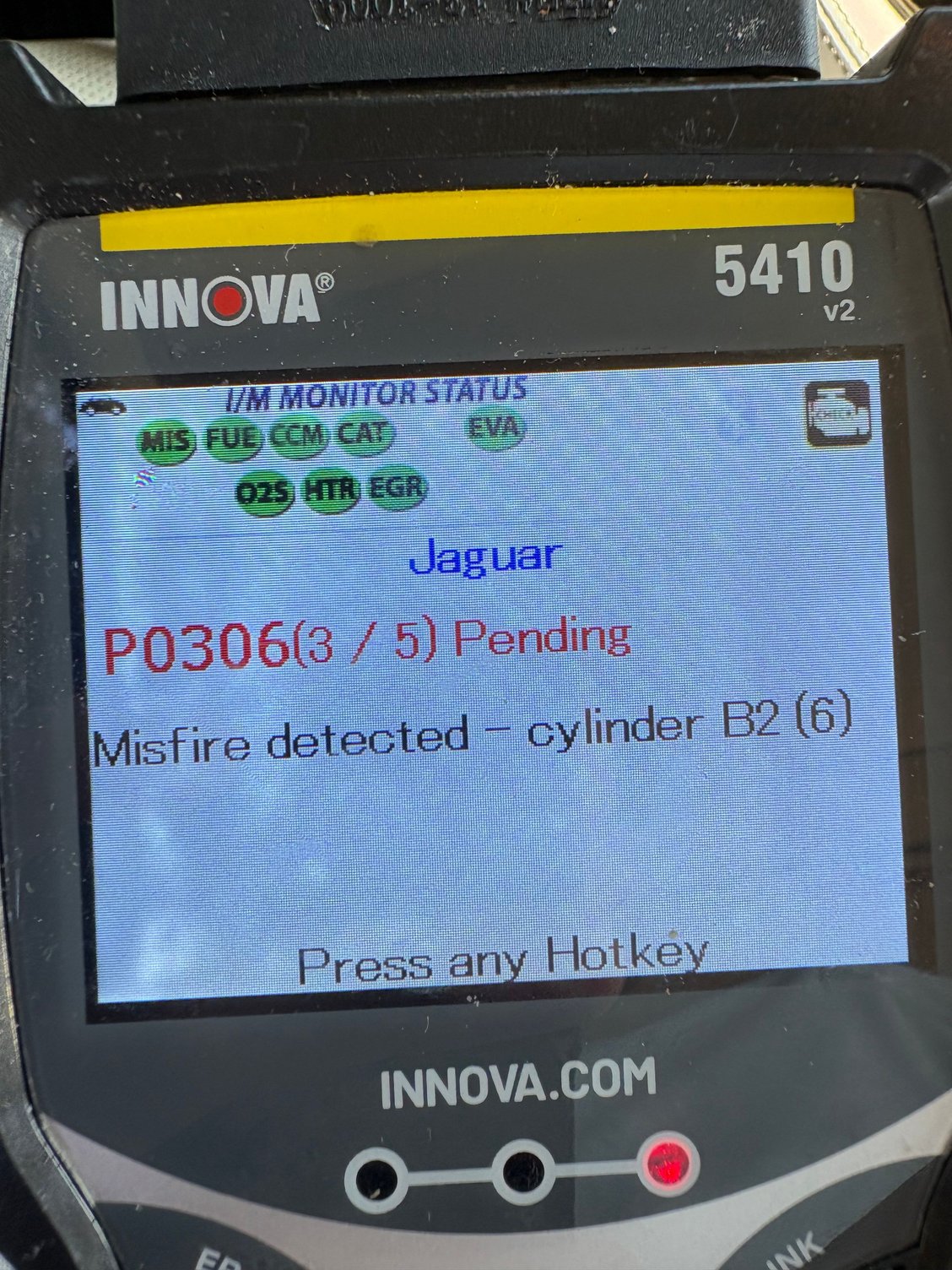

I’ve noticed that if i put the car in run and let it get everything going for 15-30 seconds before actually cranking it over it doesn’t surge and runs pretty good until it get to temperature.
But if I leave it overnight and immediately start it, it will tend to surge and hold a high RPM at idle around 1200-1500 and will hold 30MPH without throttle.
I also got 2 new codes

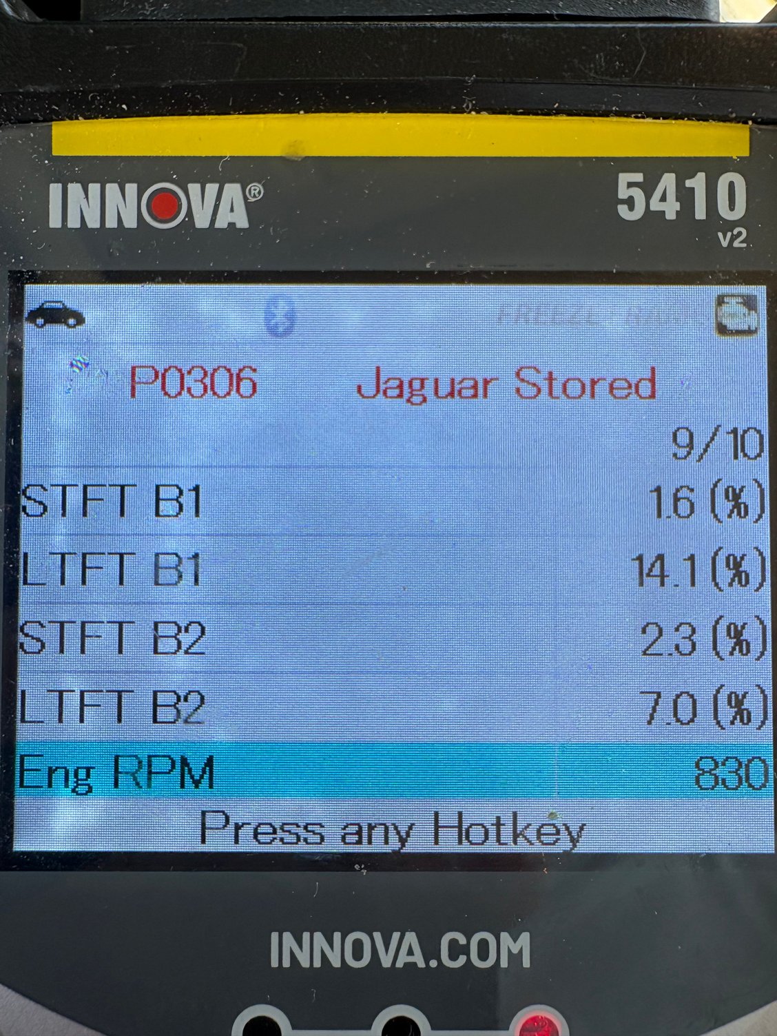

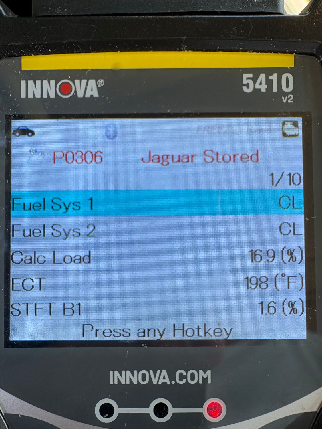

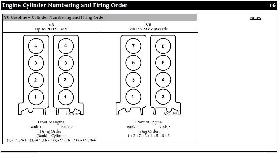

One likely cause of the Cylinder 6 misfire is that the ignition coil is malfunctioning when it gets hot. A quick test would be to remove the 6 coil and swap it with another cylinder, ideally one that is not located right next to Cylinder 6, such as Cylinder 2. Clear the codes, run the engine and see if the misfire code moves to Cylinder 2. If so, you've confirmed the coil is bad.
Another possibility is that you still have unrepaired fuel injector wiring that malfunctining when it warms up.
While you have the coils removed, check for oil around the spark plugs. Oil from leaking spark plug tube seals can lead to misfires because the oil seeps down the spark plug threads and forms an insulating layer that interrupts the spark ground path via the plug threads to the cylinder head and engine ground strap.
Here's the cylinder numbering diagram. Your scan tool may be using the post 2002.5 model year numbering system:
Your STFTs look great at just +1.6% and +2.3%
At +7.0%, the Bank 2 LTFT is a little high, consistent with the P0507 code you reported earlier.
At +14.1%, the Bank 1 LTFT indicates significantly lean running in that bank, so there may be an unmetered air leak that affects Bank 1 more than Bank 2.

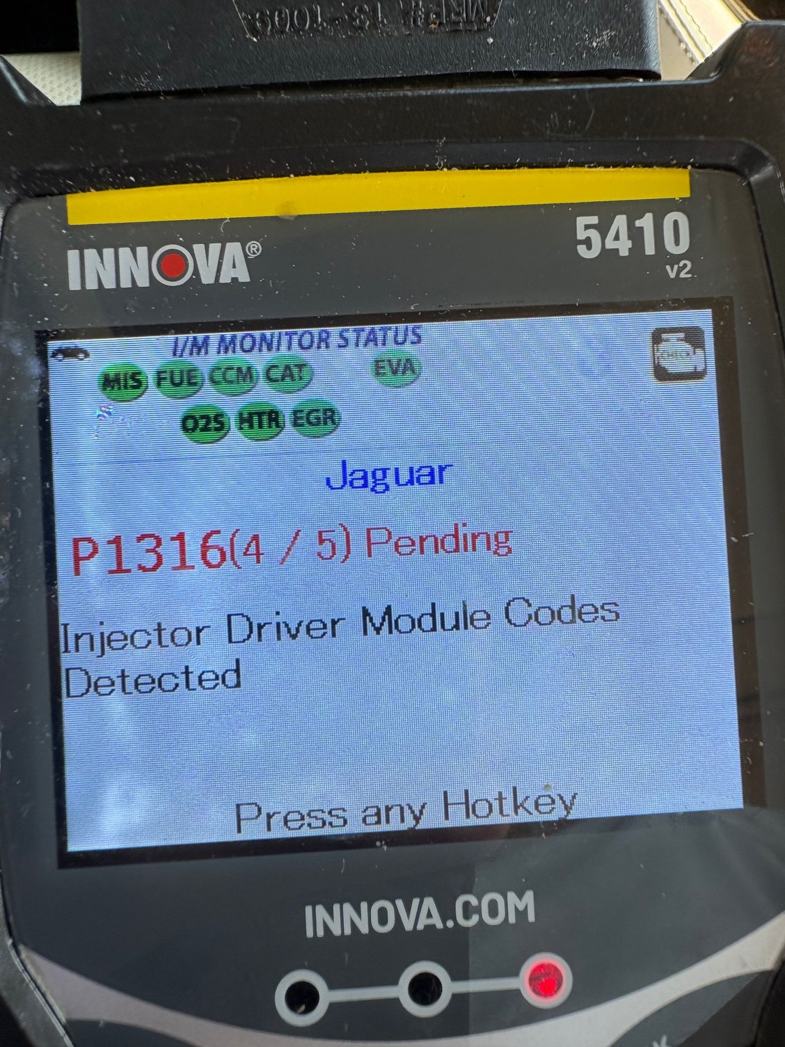

Check that P1316 in Jag doc as I think the Innova is wrong.

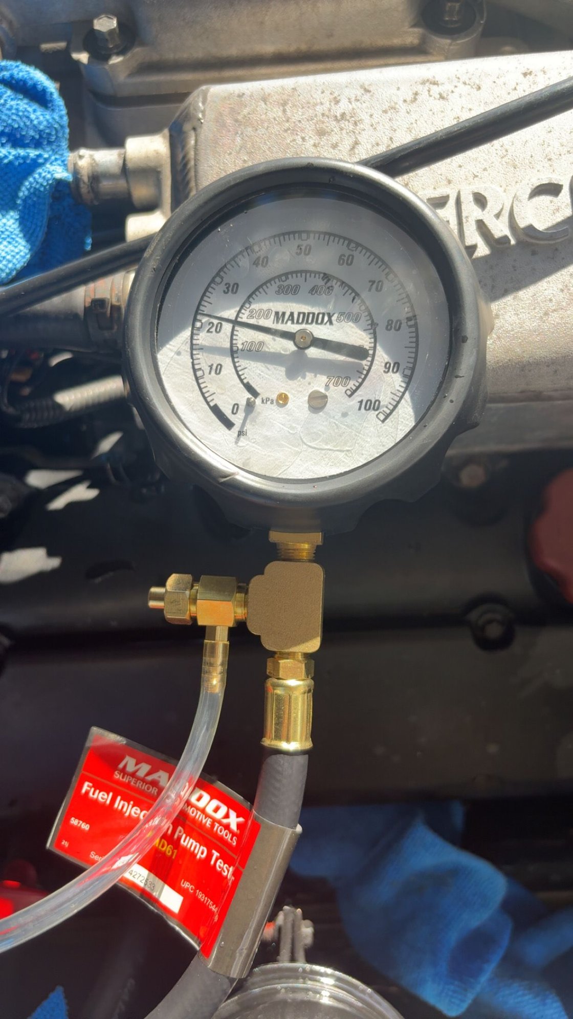

Finally was able to get a fuel gauge on it and results are not good.
Firstly the car will go into Restricted Performance intermittently seemingly out of nowhere. And when it is in restricted performance mode,when I start the car up OR when I shift from P to D or R the RPMs drop to 400 before settling around 600.
I also replaced the fuel filter when I cleared the codes and the car ran great for the first day but the second day the codes came back and ran even worse than before but I haven’t cleared the codes again since.
Now the car will misfire at anytime when it used to only misfire at Idle or after 5 pounds of boost.
I had the ignition in run and it was only showing 19PSI when I cranked it over it was only at 21PSI( I cranked it only for 2 seconds because I’ve got coolant and vacuum lines disconnected to get the gauge on.)
I also switched the coil pack on Cylinder 6, cleared codes and it still came back on the same cylinder. Could this be both injectors and fuel pumps going bad?
The PSI is also slowly going down

I believe this code always shows up along with any individual cylinder misfire, Motorcarman had mentioned it in a thread somewhere.

On fuel pressure swap or new fuel pump relay as the power contacts inside may be burnt
You can jumper with a blade type connector wire ends socket 3 to 5 but this will be hot at all times with the keys in pocket
Inspect on the fuel pump motor itself the connector halves for burnt pins and sockets ( a sign the pump is giving out )

Old Jan 10, 2026 | 02:00 AM
JagV8's Avatar
Posts: 27,550
Likes: 4,928
From: Yorkshire, England
Maybe. The Innova looks wrong. Look it up in the correct Jag DTC doc for your car.
