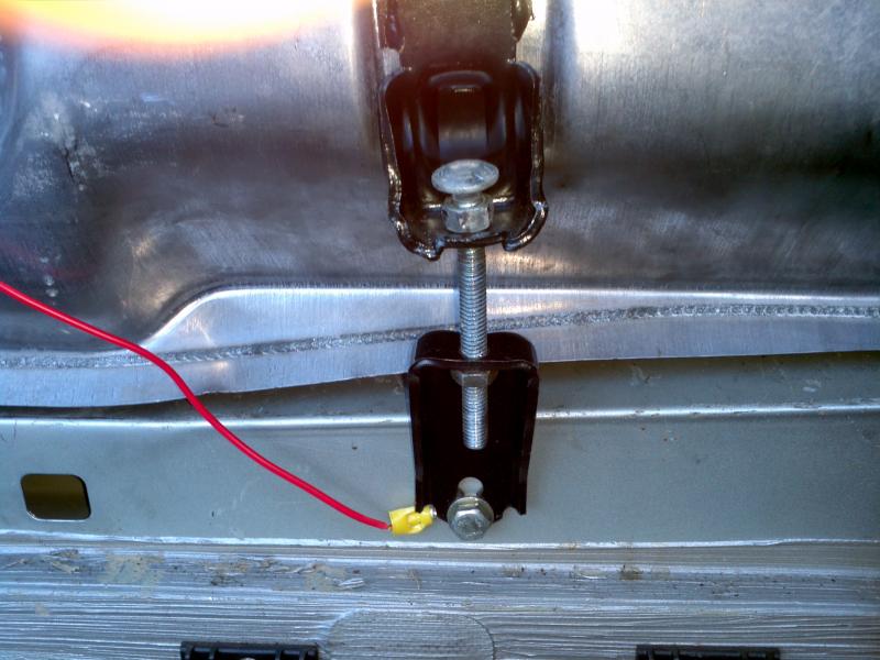

ok, the tank has to come out. i can see how most of the hoses and pipes come undone. not sure about how the filler tube comes out without damage. i found a carriage bolt on one of the straps (see pic) that doesn't look like it came factory installed, so im guessing this tanks been out before. question: is the tank usually just strapped in or is it bonded on with some kind of double backed tape or adhesive? what is usually leaking the fumes, a seal or gasket? or a component mounted to it? guesses on why they had it out before? and if i was to take it to a shop, how many hours of labor am i looking at to remove and replace the tank?
