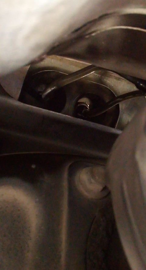

What would be ideal is getting a good picture of where the fuel lines go into the tank and post them here.

The RETURN line is ONE PIECE from the firewall area to the tank!!!!!!!!!!!!(NOT a fun job because of the length)
