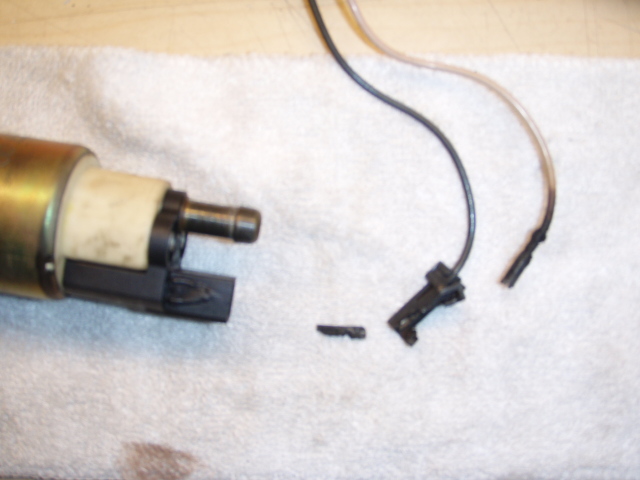

Once the pump was removed it was clear my troubles were from burned connections at the pump, inside the fuel tank. I know this is supposed to be an airless environment as the fuel vapors displace any atmosphere admitted but seeing this is none the less disturbing.

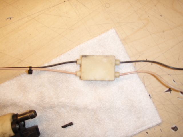

Can anyone tell me what the square inline device is between the FP and the connector? If is some sort of protection device it doesn't seem effective.

The cause of the discolouration is high temperatures and is not dependent on air. Air is only required for ignition. The connectors and wiring may be undersized for the current draw. Tuners routinely run 12AWG on fuel pump circuits because of the current draw.
Look for my earlier post about the inline module. Walbro holds a patent on a noise suppression module. Denso builds the noise cancellation into the pump itself. Noise suppression modules can also be inline outside of the tank. So ... overly complex and bad design.

The harness supplied with the repl. pump has even smaller gauge wire than the original, I hpoe this doesn't become an issue. The actual connections of the original were the point of resistance, they new one has a larger connector.
I suspected a noise supressor of sorts but it ohmed essentially zero on each lead and open between them from either side. I trusted Jag's engineers and left it in place.
