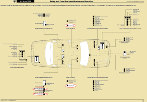

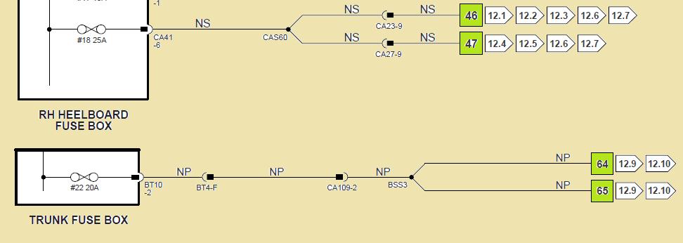

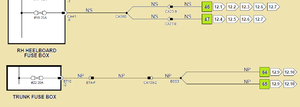

Whear is the fuse box for the front and rear heated seats on a 1999 X J 8 L?

Attached Thumbnails Fuse location for heated seats on a 1999 XJ8 L?-x308-seat-heaters-untitled.png   Fuse location for heated seats on a 1999 XJ8 L?-x308-seat-heaters-fuses-untitled.png   Fuse location for heated seats on a 1999 XJ8 L?-x308-seat-heater-fuses-2-untitled.png
