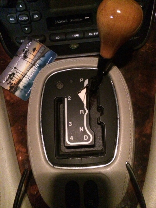

Hi again!
This is another part that broke. It is the plastic moldings for gear shift assembly marked D, R, N etc
See attached pic.
Anyone know where I can get one?
Thanks in advance!
Attached Thumbnails Gear shift assembly molding for xjr 2001-image-1862581598.jpg

It comes just with complete gear selector assembly.

Are the xjr and xj8 modules compatible?

Since they have different transmissions, I wouldn't think they are the same. They look the same from the front, though.

This part is not interchangeable between S/C and non-S/C cars.
Supercharged = LNC-6195
Nonsupercharged = LJA-6195
They are still available from dealers but cost several hundred dollars. If you want a cheaper option, start searching for used parts.
