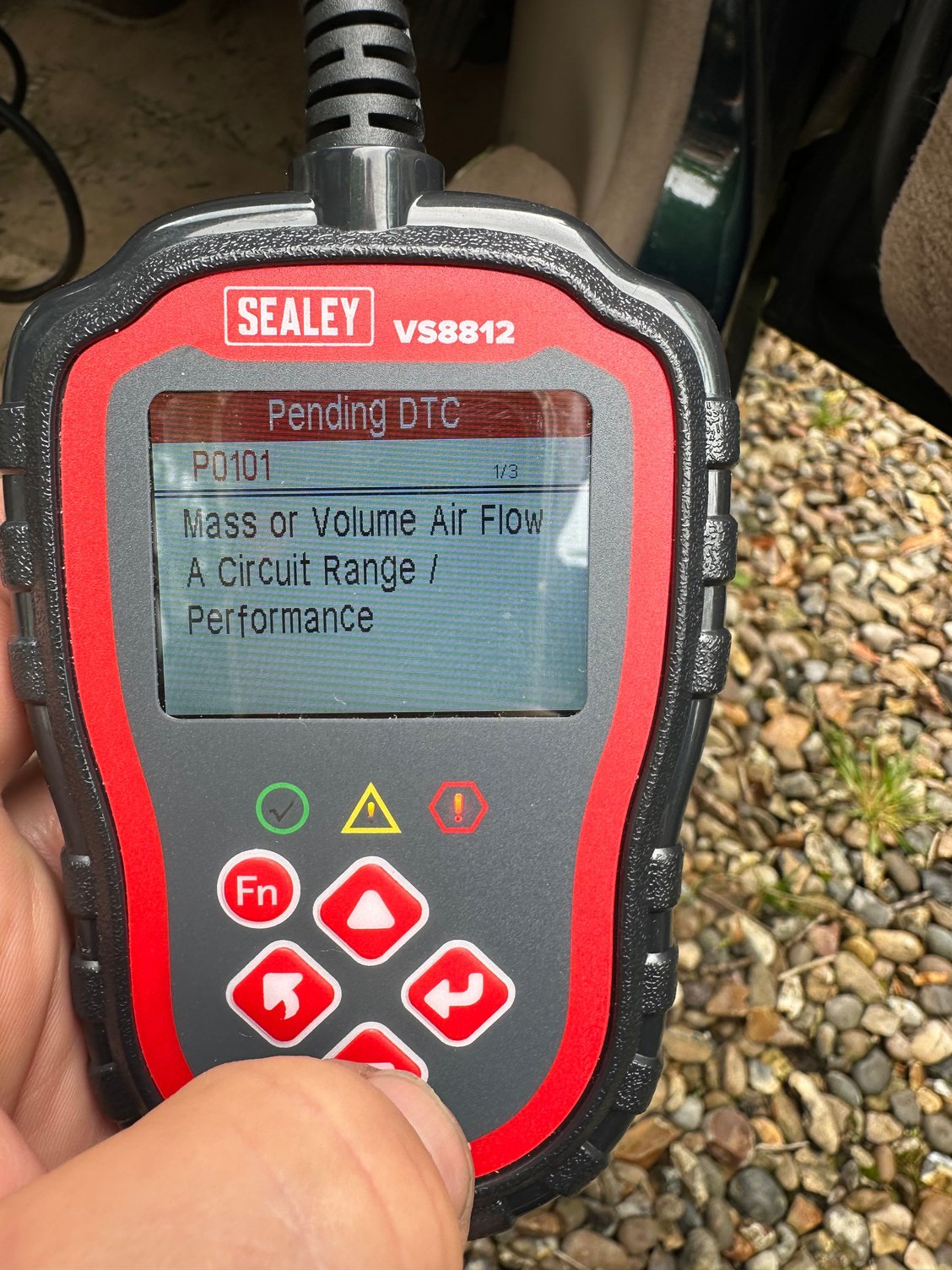

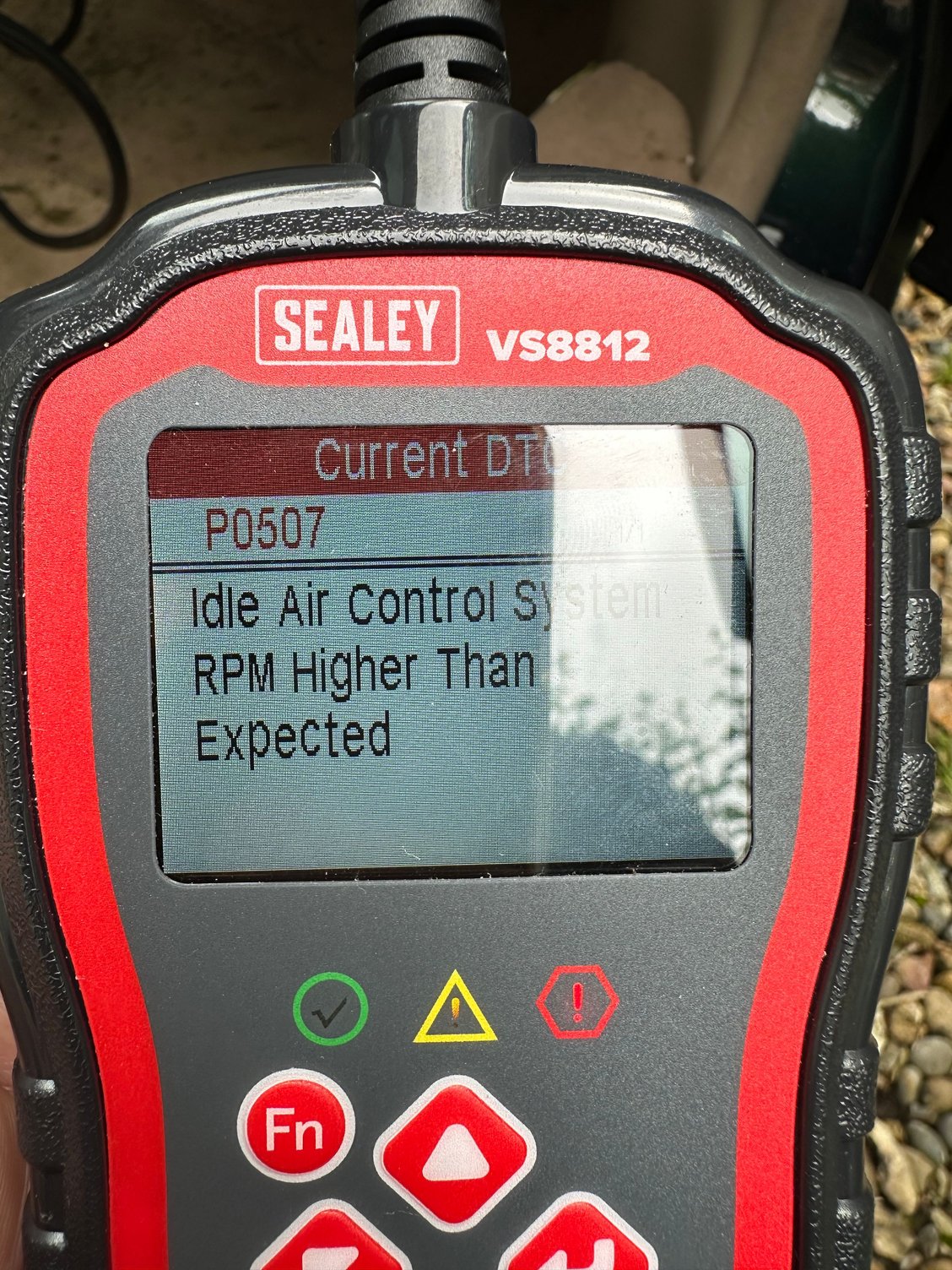

2001 XJR 4.0 sc.. The other day the gear change seemed a bit harsh but then drive ok. The second start up was ok, but at about 50mph said “gearbox fault”, then when I got home she wouldn’t engage into reverse or even D. I turned ignition off, then started her up and all was fine. The next day I started off and all of a sudden she lurched forward and I didn’t need any additional gas, it was like she was in failsafe mode. I cleared the codes but she still kept too high revs. I’m certain it is not MAF , (which is indicated by P0101) , TPS or AITS as they’re new. TB has all been cleaned and reset.

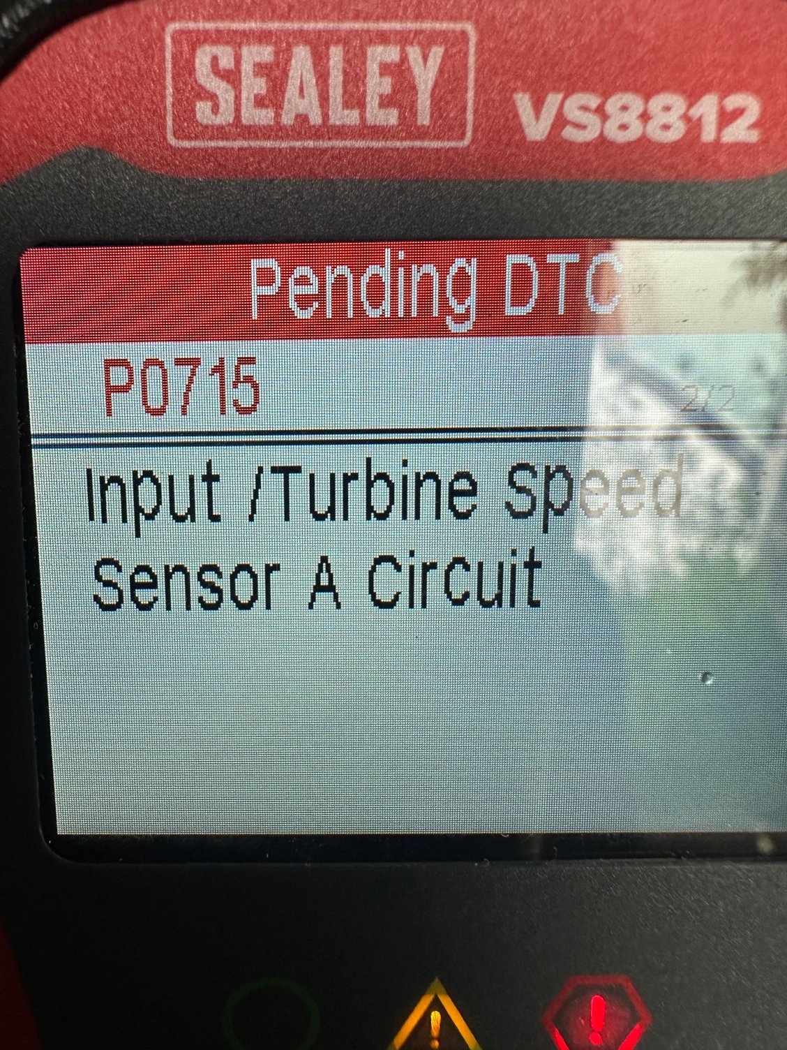

Now P0715 says input turbine speed sensor circuit? I cleared it and it’s not come back, but “engine failsafe mode” has.
Do you think that the turbine input sensor is easy to replace? Someone told me the actuator plate may need changing. Is this a cure? I’m puzzled as to why this would cause high revs.
She only goes high revs when I start to drive off, not when she’s just sitting on the drive.
Help most appreciated!

First stop for me would be the conductor plate
thanks very much.. do you think the conductor plate would cause higher revs? Is it difficult to replace? Cheers!
Conductor plate can put the tranny in limp mode which I believe limits it to 3rd gear.
Replacement is pretty easy, just disconnect the multi pin connector, drop pan, unbolt valve body, remove solenoids, swap plates, and reverse. Few hours max

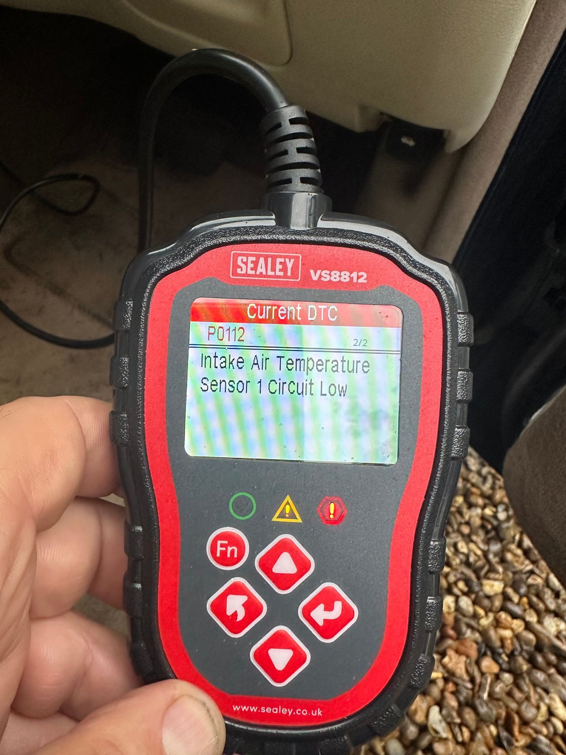

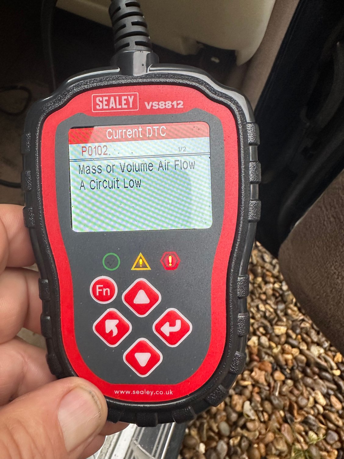

I swapped the MAF. This was quite newish with 12,000 miles on it which I had kept as a spare but suspect.
Before I did that I cleaned it with a cotton bud with MAF cleaner and sprayed the plug. I then saw this MAF had the diode slightly bent , maybe even touching the plastic protector. I carefully straightened it using a thin screwdriver (not touching the endŁ
plug the MAF back on, but left it unplugged. (This is a tip from a mechanic in the scrapyard when I was younger) started her. She ran lumpy and angry without her MAF. Switched her off for 5 minutes.
plugged MAF in, started. EML still on, with fault codes P0102 and P0112. Cleared codes whilst running. Switched off.
Started her up. All fine. Have driven 5 drive cycles, taken her up to 75 no issues, so far, so good!
I can only think that somehow the MAF created a bad signal in the middle of the journey, tried to tell the ECU to go into “engine failsafe mode” or “restricted performance “ and made the gearbox module freak out. I’m hoping that it’s not a gearbox issue after all, but this was a strange phenomenon.
