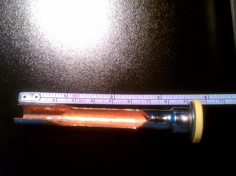

Ok, thought I would give an update to what I did. I wasn't in a position to drop the rear end due to where my tow truck driver parked the car. Additionally my driveway is on a slant and I can really only get one of the rear wheels off the ground at a time. Additionally I wasn't interested in cutting a giant whole in my rear package shelf's sheet metal to get at the top of the gas tank.
I really stuggled to get the fuel lines disconnected. I bought a few different quick disconnect tools but didn't have much luck getting the lines to release. I had a hunch that maybee the neck of the quick disconnect tools may not be long enough or they were right on the edge of being long enough.... I decided to fabricate a tool with a longer neck and one that would be easier to push on. Once I had the tool in hand it was a matter of minutes to get the lines off (by that time I knew exactly where to route my arms and hands <yes they are long and skinny>... additionally i used a pull down stap with hook so i could easily pull on the line to see if it was disengaged).
Here is what you need:
3/8" OD - Metal (copper with chrome plate) toliet connector - Home Depot
Dremel Tool - With cut off wheel and grinding bits
Time - 45mins
Time - 45mins
Attachment 4800
Attachment 4801
Attachment 4802
Attachment 4803
You 'da man! I spent the better part of the weekend trying to get my left side line loose and this worked like a charm, documented here: https://www.jaguarforums.com/forum/x...4/#post1143034
My situation was just like hispeed42 (https://www.jaguarforums.com/forum/x...e2/#post432567) and the extra depth of this tool got around that without issue.
Once I fabbed the tool, the line was out in under 5 minutes. It was less than an hour start to finish. That tool is perfectly sized. Many thanks for the detailed pics with dimensions. Homedepot or even the Mom and Pop hardware stores around me don't carry the toilet hard lines anymore, but I found it at Lowes: Shop Watts 20-in Copper Toilet Supply Line at Lowes.com .

Mike-
I'm really glad to hear the tool worked for you. Your appreciation is also very valued and comes at good time. I have had some not so fun recent life events and hearing that something I did in the past has helped someone today is really meaningful.
Thx!
