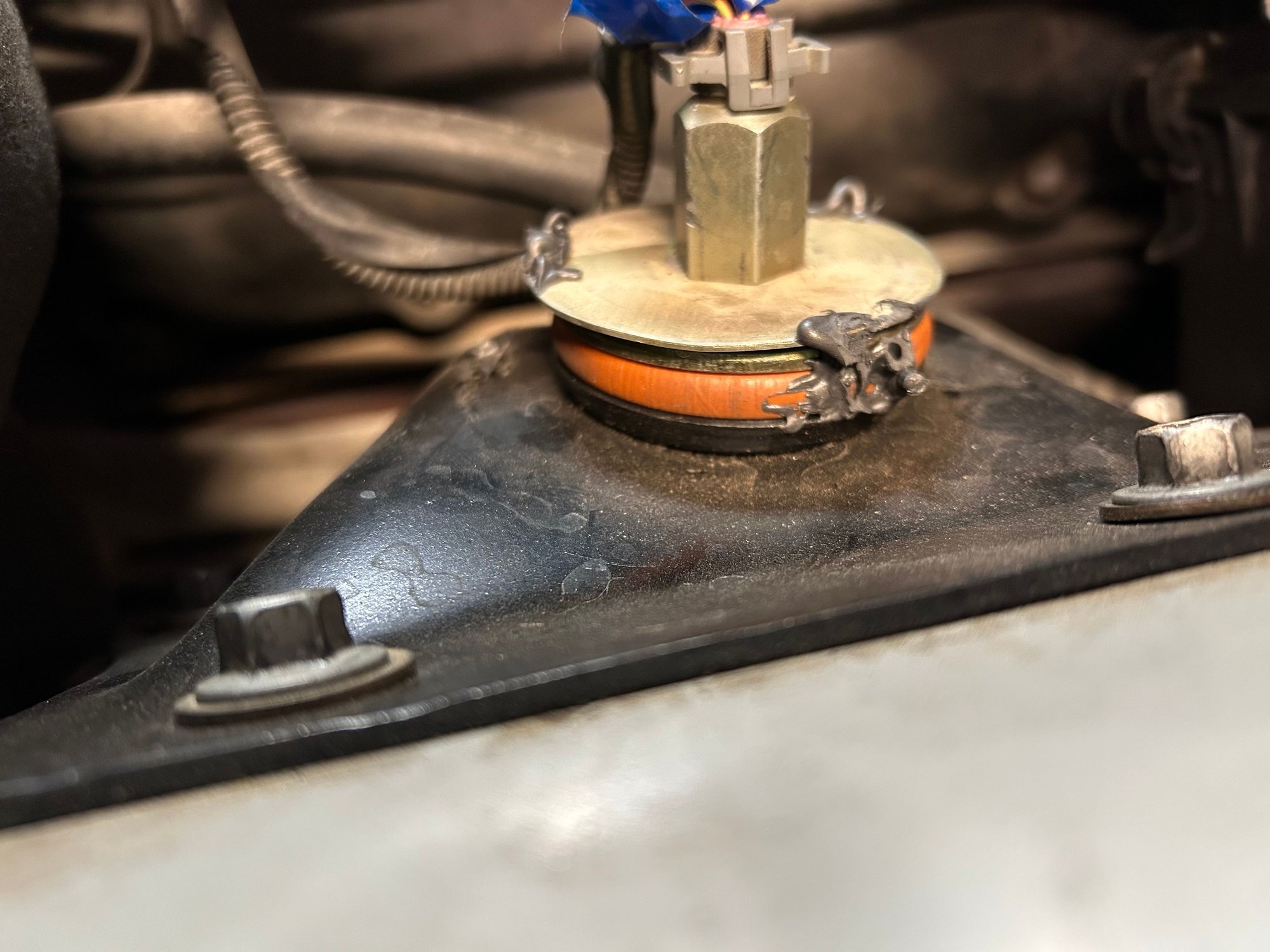

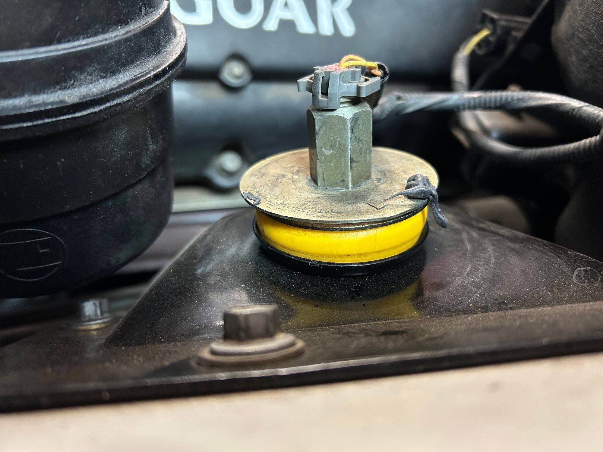

We additionally replaced the left front lower rear control arm with the ball joint and the sway bar end links. Yesterday the hard knock seemed gone. Today it is back again. How is this possible? A temperature effect?
I am considering replacing the front left upper shock mount MNC2169BE, which seems different from the front right upper shock mount.
My mechanic observed the shock mount bushings under load (see attached pictures and videos) and found that the left side seems softer, which may explain the hard knock/clunk on the left. I has a yellow color and moves quite a bit in the video. The orange one is the one on the passenger side and it appears to move less. Both shock mounts were sold as new.
Right side
Right side
Left side
Left side
Any feedback would be appreciated.
Best, SP

Old Dec 14, 2025 | 07:18 PM
sposse's Avatar
Joined: Jan 2019
Posts: 60
Likes: 12
From: Albuquerque
A new upper shock and spring mount plate for the driver side solved the hard knock.
