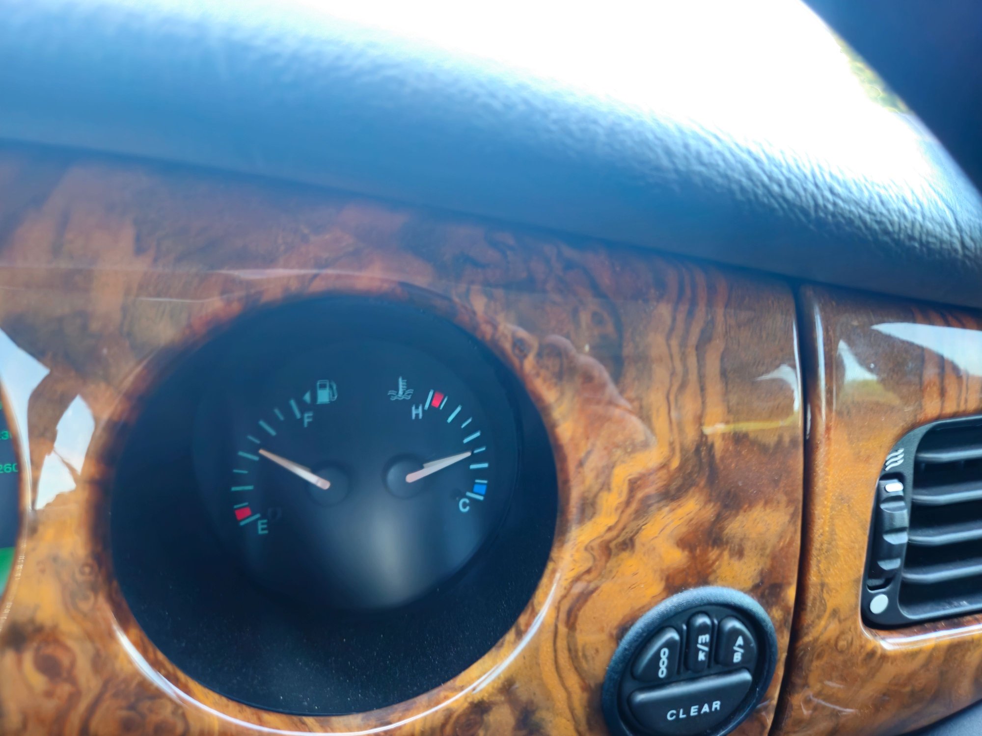

so I am brand new and just picked up this 99XJR 105k about a week ago, I've been doing a ton of searching and getting all sorts of good info - thermostat, aux pump, clogged core ect. Maybe too much info for a new owner, so I was just looking for a little direct advice.
being unfamiliar with the vehicle im not sure if it has a normal operating temp range or if after warming up should remain centered on the gage. When freeway cruising 65-70 the temp gage runs a bit cold a bit over 1/4 reading on the gage and when idel or slow town cruising it runs in the middle right where I would expect it to.

Looks to be in the right range. Not clear what your problem is? Not getting heat? Worried the engine is overheating? Also useful would be to know where you live, Cold starts in winter a whole lot different than Riyadh . . .

Sorry for the lack of information - both those pictures are after the vehicle has completely warmed and come to temperate but if cruising the freeway the temp actually drops - 74 degrees out today when operating.
I get no heat from the vehicle at all no matter the temp unless the engine is at about 3k or greater for 20-30 seconds after warm. then the heat starts to come in and feels strong. no matter the setting on the heater there is no heat only cold air if the engine is under about 3k rpm even if at normal operating temp.

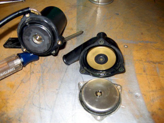

Did you verify that the pump impeller is not seized? Did you open-up the impeller housing as shown on this pic:
I found the article I mentioned earlier, PDF file attached.

Opened the housing and took apart the bottom and it spun freely and I can't believe it.... I didn't even check the top end - I had originally thought the control valve was the pump and after taking it out and taking it apart and realizing this ain't no pump I was a bit flustered. That being said I did learn and made for an easy core flush so still a win.
I'll reset the coolant lines properly and rip the pump out again
