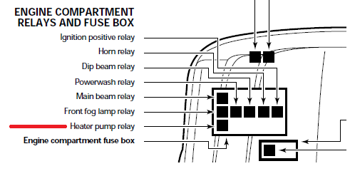

Feel for the water routing solenoids and heater pump relay to click as you turn it on
Heater pump # 3 / 10 amp engine compartment fuse box ( relay control )
Swap relay # 1 Heater pump engine compartment fuse box , there is a # 15 / 10 amp fuse in the box
Solenoid has no relay or fuse .

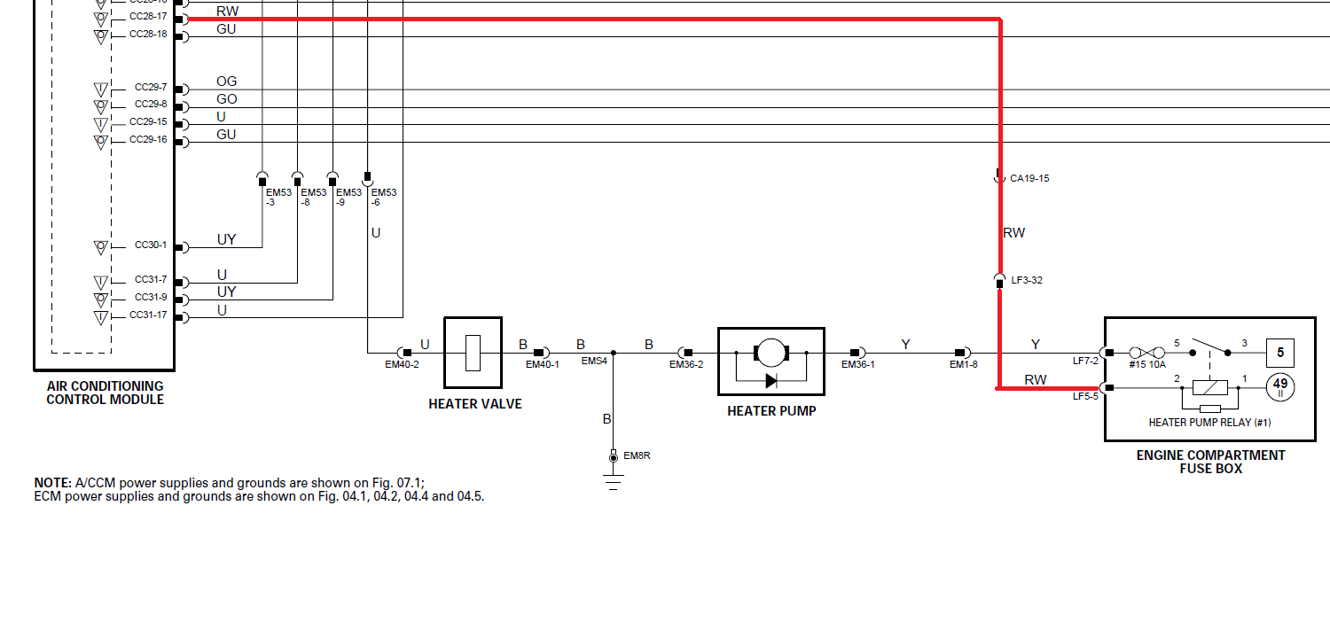

Where is the heater control valve (Item 1 in the diagram below) located on an XJ8? Are these know to stick in a closed (or partially closed) position? When there is power to this valve it is open (water flowing) or closed?

I was about to mention the valve yesterday already.
It is located in the engine bay, against the firewall, under the middle cover.
I have read they do break down (get stuck) from time to time, mainly caused by a reaction of the seals to (wrong?) coolant.
The valve is modulated (so not "on-off"), and gets 12V in pulses.
If the temperature is set on HIGH, the valve should read ~6.5V if memory serves well.
If you lower the temperature setting, The valve will get shorter or longer pulses of the 12V, and closes accordingly partially or completely, depending the dash setting.

In a pinch you " may " be able to remove the motor and fix the valve open using the blower fan speed to control cabin temp . Some valves have a lever on the side and could move the valve and fix with the connector removed .
h iall thanks for the info on heater motor.now this is were i am with it.i have fitted a secondhand motor which works well.but after fitting still did not work off the vehicles electrics.so i found that fuse 3 in the engine fuse box was blowen.i also found a link on here telling me what was the cause of the blowen fuse .which turned out to be the alarm sounder.so after disconnecting the plug to sounder bingo the fuse was cured.but still no heater pump working.so next i pulled the relay and put a jump wire on 2 of the connections and then i could hear the pump running.so now i have tried a relay from one of the other relays fitted in the same fuse box and still nothing.now surley not every relay is duff so has any one have any idea of what it could be thanks
Lady Penelope
close
- Join DateApr 2017
- LocationKansas City USA
- Posts:4,039
Likes:1,062
Liked:1,397 Times in 1,096 Posts
Yes , relays come in many different ratings , swap with one with the same part # as the ones in the truck has midrange relays
hi lady penelope .as you know there are a few relays in this fuse box in the shape of a t.well would not all of these be the same as i have tried every one in its place and did not activate power to the pump.,but if i put a jump wire across 2 of the relay terminals bingo all works.,maybe do you think it has to be the correct one.also y on this thread would you know if the heated seats and front and rear window heaters only work when motor is running as they have mystery stopped working.thanks

I'll get to the window and seat heat on the thread you opened on those issues as your priority is the cabin heat with front window defrost
See Highhorse's reply on that thread and I agree . Jaguar's like full tummies as a full battery charge of 12.77 volt and as it gets lower the ECU's act up one being the Climate Control ECU which provides a ground to pull the power contact on the heater pump relay . As the heater pump brushes arced the relay power contact probably arced as well and was damaged .
